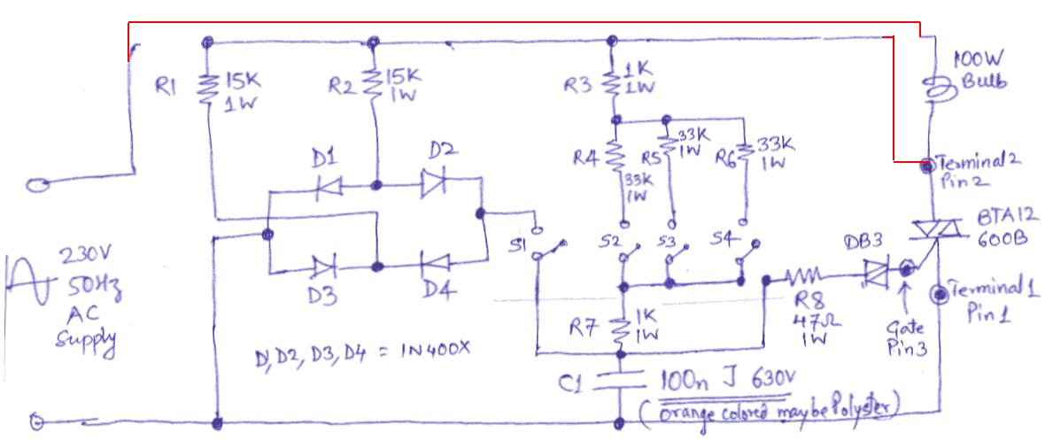

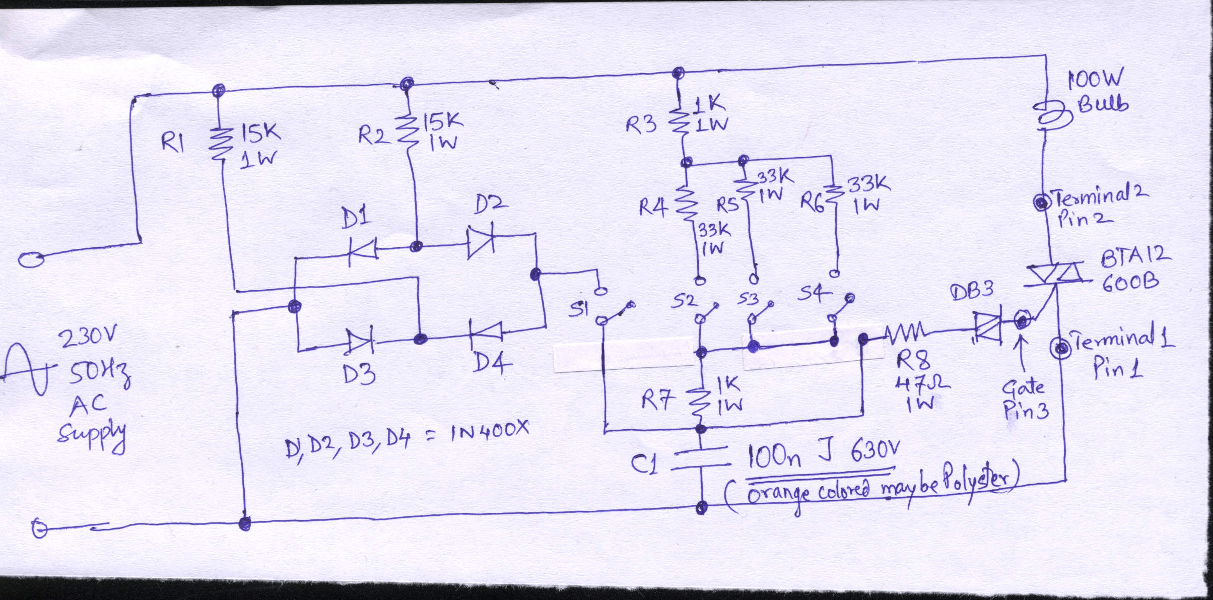

Hi, I have spent sleepless nights on this simple circuit that refuses to work. Can some one please help with with what's going wrong here ?
I am using a 230V A/C, 100W filament bulb as a load.
-> S2 on , bulb is not switched.
-> S2, S3 on, bulb is on and dimmed
-> S2, S3, S4 on, bulb is on and more brighter.
-> S1 on or off has no effect on the bulb brightness.
I googled and this circuit appears in many places and instead of R4,R5,R6 a 220K or 470K pot is used. However, in my experience, the bulb does not light up if R4+R5+R6 is more than 33K.
Also, R4,R5,R6 get hot. My question is why do I require so low value resitors (< 33K) for my circuit when everyone is able to handle it with 470K pot's ? I actually want to use a pot and want to have multiple dimmings settings.
R1 and R2 get very hot too. May be I should use 33K 1W or 15K, 4W resistors.
Here are my some debugging attempts
-> Instead of R4,R5,R6 I used a 16mm 470K pot and it smoked. I tried a 23mm 470K pot and it fumed too. Both were carbon pots. Should I try using 470K wire wound pots ? Problem is wire wound pots are not available for values greater than 100K
-> The capacitor has 100n written on it. I assumed its 100 nano farads. I even tried with a capacitor with 0.22 uf written on it. No change in behaviour
-> I have built this circuit atleast 5 times with FRESH NEW components.
-> Does it matter how I connect the Main Terminal 1 and 2 of the triac ?? Some websites state that it does matter but I thought these days triacs are reliably symetric.
Not sure what is going wrong here ? Are the BTA12 faulty or not behaving as per design ? These days the market is flooded with cheap chinese components hence its difficult to differentiate the real authentic ones with the fakes one's.
A comic circuit. Better circuit are in internet. I think r3,r4,r5,r7 connected to downwards ie, the other supply terminal where bulb is not connected. 220K pot will go but a good Wattage is must. I can't understand need of D1,D2,D3,D4 and associated idiotic things wired.
Dear Techie7,
What is your exact point about R3, R4, R5, R7 ?
I would request you to avoid using the words "comic", "idiotic" because they are against the spirit of this forum.
The Diode network indeed has a purpose but now that you call it idiotic, I would avoid giving the reason. Anyways, there is a switch to put it out of the circuit.

I don't have the time right now to look at the core problem, but a quick calculation shows that R1 and R2 are dissipating 1.8 watts, higher than the 1 watt max they are rated for. That explains why they are hot. They would have to be 27K ohm to get them down to dissipating 1 watt, and resistors really should never be run at more than half their rating for good reliability.
Probably the original schematic was designed for line voltage 110v, not 230V.
Have you tried S2, S3, and S4 with the capacitor disconnected, and S1 off? If so, what is the result, for each switch combination (S2 thru S4)?
Roger, EM.

I looked at the data sheet for the BTA16-600B and it requires a whooping 25 mA of gate trigger current for quadrants 1-3 and 50 mA for quadrant 4. I think the difference in gate current for quadrant 4 explains why flipping MT1 and MT2 matters. The fourth quadrant is the quadrant where the gate voltage is positive and MT2 voltage is negative. The high gate current also explains why your resistors are hot.
I think you need a more sensitive triac for this application, say one with a max 5 mA gate trigger current like the BTA316-600D and connect the capacitor between MT1 and the gate. Alternatively, you can use a sensitive gate triac to trigger a large current triac with a not so sensitive gate.
The sketch requires a small correction, see attach.
I agree with the modification provided by EM2006. This will greatly reduce the power dissipation in the resistors. That is because when the triac turns on, the voltage across the circuit components drops to a very low level, waiting for the next half cycle. During triac turn-on almost all of the line voltage is dropped across the load (lamp).
Of course, at full diming the triac doesn't turn on, so R1 and R2 have to selected for full voltage, but the gate resistors only have to selected for the RC current at the mains voltage, but without continuous gate current as in the unmodified circuit.
