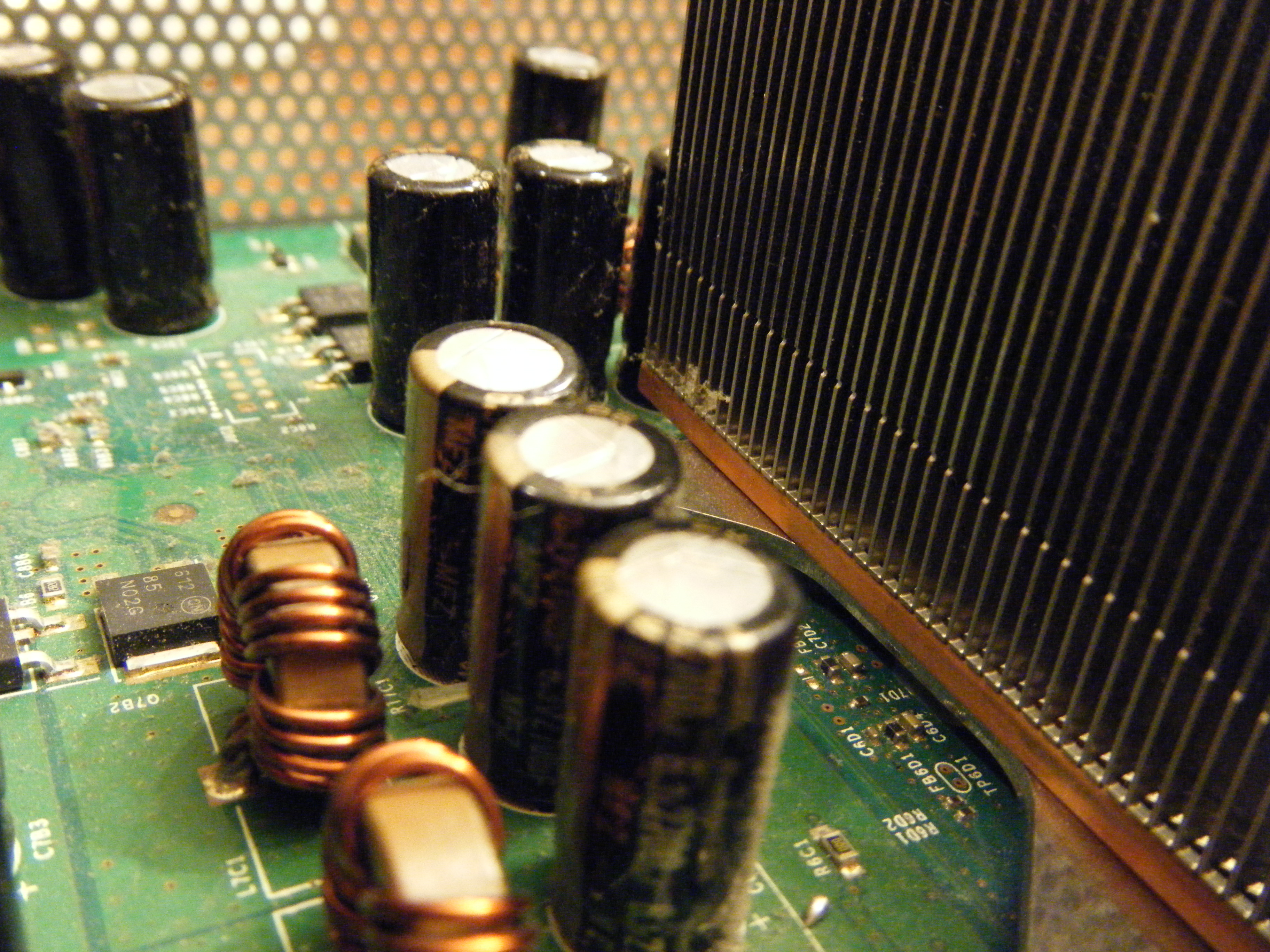

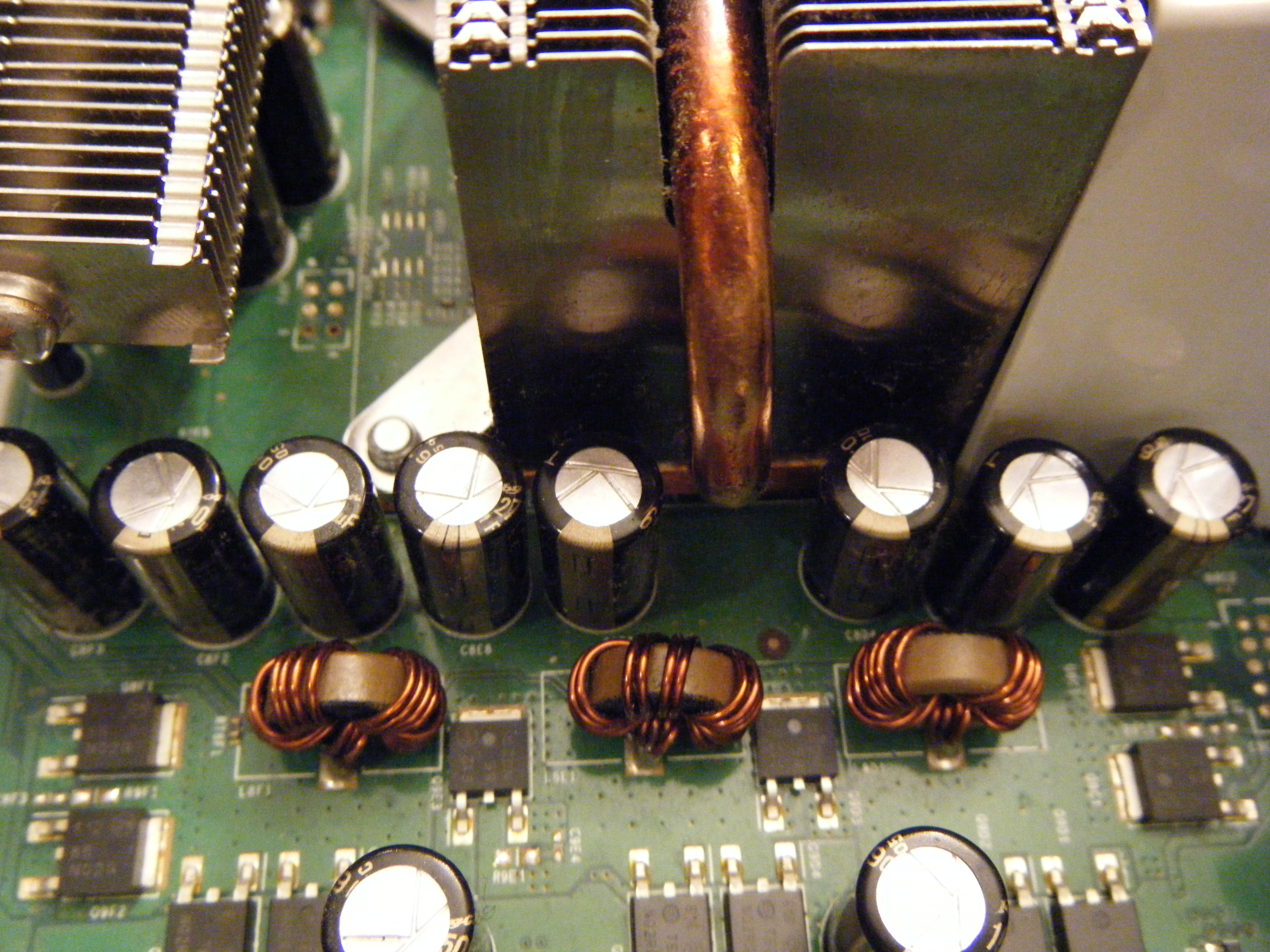

I just received an Xbox, my friend complained it would freeze when you would start a game.
It is out of warranty, so I opened it up. Upon inspection, I saw a few barely bulged rubycons! I fired it up with the cover off, and the red ring of lights flash on and off together, the fans run, and the heatsinks inside start to get warm after 5 minutes or so.
In conclusion, I am not quite sure if this an overheating problem, or a bad capacitor problem.?:confused:? I will post a few pictures later today. I will also check the voltages too later today.

And the bulging caps are Rubycon MCZ series which according to the web, can be bad.

I found my camera and finally took a few shots

I was just thinking that when the GPU and CPU need a lot of power, the bad capacitors let excessive ripple leak into the [GPU/CPU] power and cause one or both to freeze.
That is most likely the case, and it will be a easy fix :)
