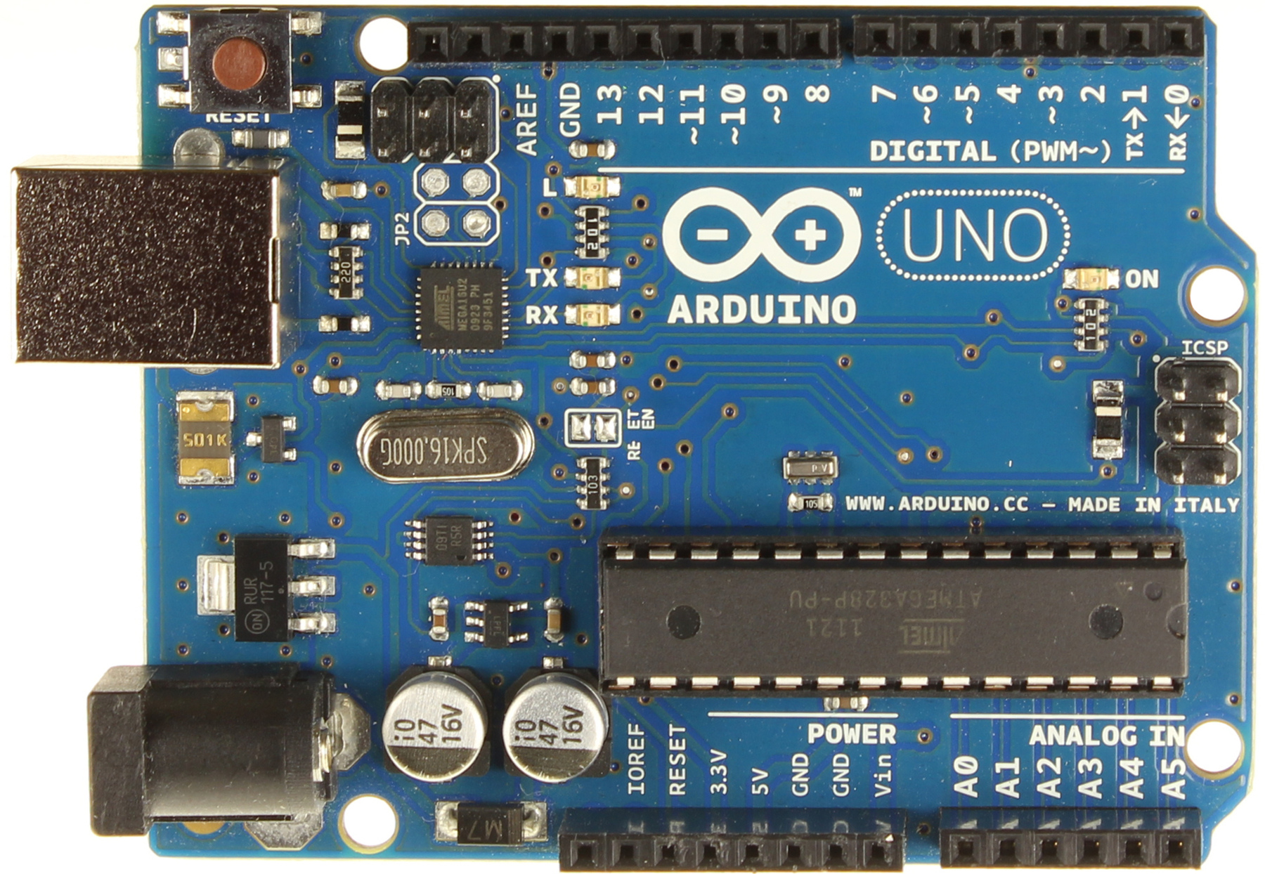

If you click it you can see the parts the regulator is a 117-5
