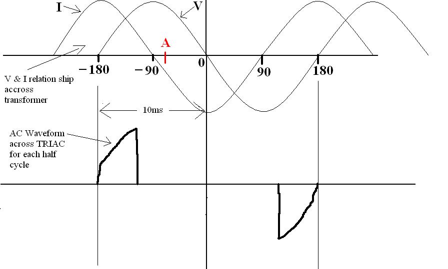

Hi
Just wanted to discuss another method before i go on with hardware mods....
Currently my PIC MCU gets interrupted @ every 10ms (zero crossing) with normal non-inductive load. However when I connect the transoformer inductive load then I do not get interrupts at every 10ms since the zero crossing is now occuring at every 5ms due to the V & I not being in phase....(by 90 degree I lags V)
Please see the enclosed attachment.
So inorder to make the firing of the TRIAC symmetric during both halves of the AC wave.....i have come up with a software fix for my PIC MCU which I will now describe as below.
As per the enclosed attachment, lets suppose the first time the PIC is interrupted at zero crossing at -ve 180 degree. I then shut off the zero crossing interrupt. I fire the TRIAC as normal and let the TRIAC conduction continue to my desired level. Then at point 'A' which is approximately at 6ms I then turn back on the zero crossing interrupt. Hence the next zero crossing will be occuring at 0 degrees which is exactly after 10ms. The same logic then repeats over. By this method I predict that the TRIAC voltage wave form will be symmetical as shown in my diagram. This is how i intend to over come my problem of V & I not being in phase in an inductive load.
Please comment/suggest or modify or correct my logic if im wrong.

As I stated before you go back wards with triac or SCR switch's on AC line loads.
You turn on the triac starting at the end of the wave not the beginning.
For low voltage output you only use a small part of the trailing end of the wave. For more voltage you move the triggering point further forward on the wave.
When you trigger the triac at the very front of the wave you will get the full voltage.
Its how its done on many welders and works very well. Even with higher voltages and tens of KW's of inductive power.
Flip your picture around from front to back. (mirror image) Thats what wave form your looking to get.

Say you had a half wave that was 100 counts long.
When your sine wave crosses the zero point(count 100) you reset your counter back to zero. The next time the wave crosses the zero point(count 100 again) for the other half of the cycle you reset your counter back to zero again.
If you trigger your triac to wards the end of the count cycle, around 90 counts, you will only get a fraction of the wave form energy then (10% duty cycle). A triac has to have the voltage reverse in order to turn off. That reversal is the next zero point crossing, or the count 100 reset point.
By triggering at the end of the wave form there is only a short burst of energy transfered. As you trigger closer the front of the wave form (less off time, sooner trigger point) you will get more energy transfered. (greater duty cycle)
Think of it as crude PWM using a sine wave. But instead of triggering at the front of the timing cycle(count 1) you count going from the back end and move forward to make a longer pulse width. turning on at count 20 is a longer pulse cycle(80% duty cycle) than turning on at count 50 (50% duty cycle).
Your triac turn off point is fixed by the next zero crossing point. So to get longer pulses you need to move further forward on the wave when triggering the triac.(smaller count numbers)
Hence the moving from back to front for longer pulse widths.

But there is just one more thing. What im about to ask has nothing to do with programming concept being used or how to increment a variable in the software etc......that I know......the question now being asked is from the software algorithm point of view.
Thus my question is....from first zero cross INT and until the next zero cross INT, which is 5ms delay (half wave @ 50Hz),....how will i count to 100 or any number when im only getting zero cross INT? At the moment I can not understand how will the count be incremented when i hav no external tick between each zero cross INT.....do you understand my point? I mean i can start/reset a counter at zero cross INT and then keep incrementing it my self after a certain interval.....or I can use a timer being set to INT between 1 to 5ms. The desired timer INT setting will then produce the desired dimming intensity since i will fire the TRIAC only after the timer INT. This timer will be start/reset in the zero cross Interrupt Service Routine. Is this how you mean?
Currently with the perfectly working hardware and software configuration that i have (for non inductive load).....im starting/reseting a timer always set to a fixed value of 100us at every zero cross INT. So the TRIAC is firing just after (or 100us later) from zero cross INT.
Do you think with all this discussion going on with you, that my solution to inductive load dimming is clearly related to a software tweak? I have seen many inductive load hardware design dimming concepts which are exctly how I have described it in the begining of this thread (except for the light bulb ballast). My boss does not agree with the light bulb, even at 5W/230V:(. He says its a cheap fix and will only heat up the enclosure box too much.
Please advice/suggest/recommend. I need your help.:)
