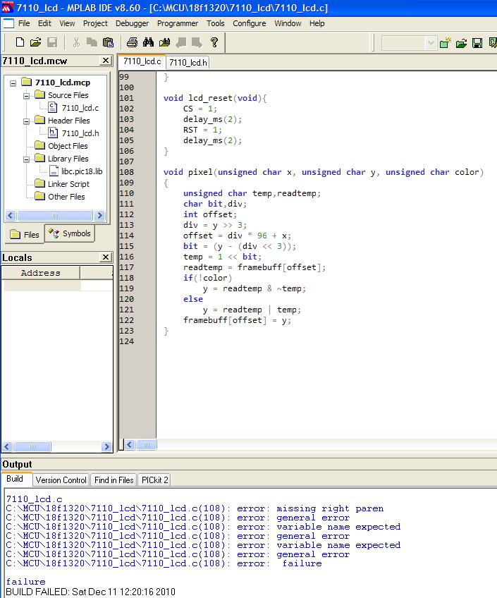

Hi guys. After a long break from it I'm back tinkering with MCUs.
I'm trying to compile a program with BoostC and getting bogus error messages.
The errors follow that pixel() function when I move it elsewhere in the source file, so it isn't being caused by something above it.
Here's the prototype line from the header file:
void pixel(unsigned char, unsigned char, unsigned char);
I seem to have some vague memory of having this problem back when I first started using BoostC, and solving it. But it's gone now. :D
This code compiles correctly on another compiler (for another MCU).

void pixel(unsigned char x, unsigned char y, unsigned char color)
    unsigned char temp,readtemp;
    char bit,div;
    int offset;
    div = y >> 3;
    offset = div * 96 + x;
    bit = (y - (div << 3));
    temp = 1 << bit;
    readtemp = framebuff[offset];

Fixed.. you cant use the name "bit"

I guess in BoostC "bit" is a type
You see posting full code helped a great deal :D
