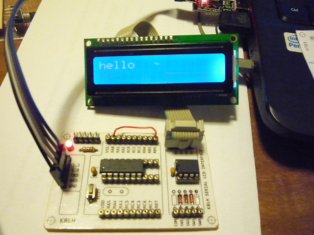

I finished up a little C demo program, similar in function to Jake's Temperature Monitor program, that supports a single DS1820, DS18S20, or a DS18B20 with selectable Celsius or Fahrenheit (one decimal place) display. Currently I'm working on a 1-Wire "SearchROM" routine so that I can select and monitor multiple DS18x20 sensors all on the same 1-Wire I/O pin. I've done this in assembly language before but not in C.
Regards, Mike
the board looks realy good what did you use for the writing on the top of the pcb?
That's a plastic laminated paper silkscreen (picture below) on a Radio Shack prototype board (sku 276-149). Wiring on the copper side of the board is point-to-point using #30 Kynar wire (picture below).

i use vario board sometimes but havnt used the board you used before the laminated silk screen is a brill idea!! we have a laminator so nesxt time i use vario i will give it a go! what do you use to stick the screen to the board? and what program did you use for the layout as i didnt know you could get software to do boards like that. orrrrrrrr did you use something like eagle in a fancy way???? sorry for all the questions :D
It's plastic shipping tape so I guess I probably shouldn't have said 'laminated'. Sorry!
... and what program did you use for the layout as i didnt know you could get software to do boards like that. orrrrrrrr did you use something like eagle in a fancy way????
I created a board in DipTrace (a PCB program) using the exact dimensions of that Radio Shack board. Then I printed the silk screen layer as an XPS file which retains precise dimensions when printed on a Laser Printer in one of the computer labs at school. Then I put the plastic tape on both sides and cut it out with a paper sheer. I've only tried this technique on a few boards so far...
