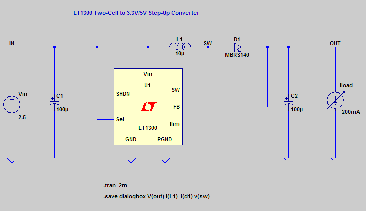

does anyone have a simple circuit for a 2-3v to 5v boost converter?
I'm looking at Fairchild's FAN5333 boost converter, marketed as a constant current serial led driver, but should be easy enough to use as a low power voltage regulator.
I want to power my 5v led spinner from a pair of AAA batteries and I need 250-300ma of current peak, but not continuous. The batteries don't have to last forever, so efficiency isn't a huge concern, just small size.

@ronsimpson
i want to regulate to ~5v, with variable current
From what I see in the datasheet, replacing the single current sense resistor with a voltage divider should have it regulating voltage instead of current. I calculated 100k and 6.65k will give me the 0.315v feedback voltage required by the FAN5333B, resulting in 5.05v which is close enough.
Any flaws in that thinking?
The 5336 is nearly twice the price and in a much harder to hand solder package - no hot air reflow station for me yet.
@hero
thanks for the schematic ... Linear isn't an option right now - the vendor I'm ordering from doesn't stock their parts, and the LT1300 is $5+ elsewhere, versus less than a buck for the Fairchild part. National is also off the table for similar reasons.
