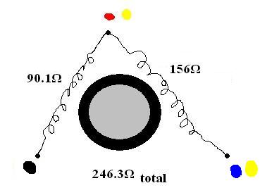

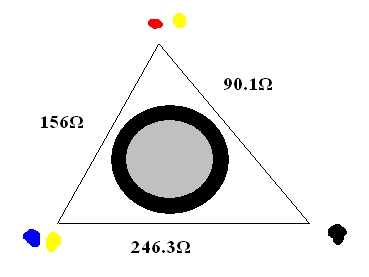

So, there are 5 wires coming out of the motor: yellow, yellow, red, blue, and black. Upon opening the housing I found that the red and blue wires were each connected to a yellow wire (and each pair measured 0Ω on a multimeter), so now I'm left with Red/Yellow1, Blue/Yellow2, and Black.
Resistances are as follows:
black - red: 90.1Ω
red - blue: 156Ω
black - blue: 246.3Ω
Looks like I'll be needing a capacitor to get this thing started? I don't think I saw any centrifugal clutch though, why else would it say CAP? I've tried wiring the three wire sets in every possible way to wall power, nothing's working. What am I missing? I'm pretty ignorant when it comes to anything but simple motor circuits. :S

Sorry, here it is.

Would the capacitor, assuming 2.5mf @ say, 200v(?) go between the two yellow wires? I'm thinking, could they possibly have been wired like this before? All the original wiring is lost, so all I have to work with is this.

I already ran the number across the site, didn't come up with anything. I think at this point this is a Permanent Split Capacitor motor.
Permanent Split-Capacitor Motors
If anyone could help me out to design a variable speed controller or basic hookup, I'd greatly appreciate it.

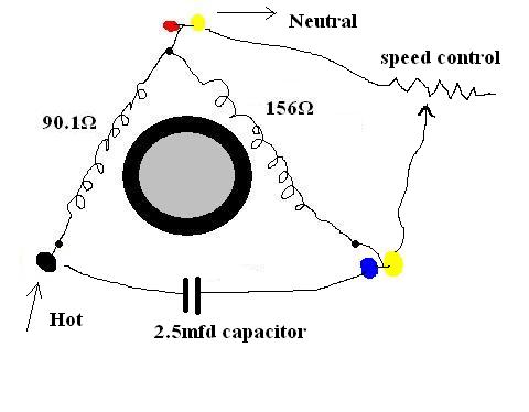

All right, well I hooked up an old 1 mf (2100v tee hee) cap from a microwave between the black and blue leads. Ive included the updated schematic. The above site REALLY helped. I figured the coil with greatest impedance was the secondary. I'm gonna experiment with what happens when the coils are swapped. I'll look around to find a cap of the correct value. I'm also assuming that a variable resistor between the yellow wires (on the secondary coil) would control the speed?

Reversing the configuration (cap between blue and black, but hot going to blue this time) just leads to lower RPMs and torque, as well as slower starting. Hmm, learn something new every day. Any input would be appreciated!

Thanks so much for the info. I was able to get it running, surprisingly the grease is still good, along with everything else. I'm starting work on another control panel and mounting bracket. I'm ordering a 2.5mfd 600v cap online, I'm wiring this from the hot side of the primary coil to the secondary. It seems to be workin' like a charm.
Wait, how would I go about wiring a speed limiter? Would a variable resistor work? or something more complex?
Would a variable resistor placed here work?

It's a synchronous motor. Its speed is dependent solely on the input frequency unless it is overloaded.
Since a resistor is a bad way to control a synchronous motor, there is no correct place to hook it up.
When the coil is shorted completely (through yellow wires) the motor stops. Wouldn't placing a variable resistor between the yellow wires work?
