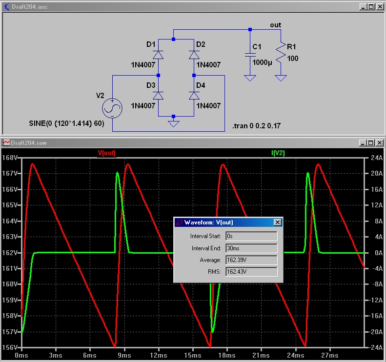

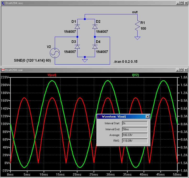

Always thought you multiplied AC voltage times 1.4 when you used a bridge rectifier? Was I taught wrong?
You where taught right.
Thats a number someone eles gave that ran a DC motor of AC. It may be wrong.
Go to about mid-page here: https://en.wikipedia.org/wiki/Full_wave_rectifier
It depends on whether you want to define the peak DC voltage or "average" DC voltage. One might consider the motor inductance to provide some averaging. The subject comes up frequently in discussing PWM of large motors. The 4QD site used to have a nice discussion of that and its relation to frequency.
John
Only true if you filter the full-wave rectified output with a huge capacitor. Look at these two cases:
In the first, no filtering, only pulsating DC applied to the load R1. The voltage source is 120Vrms at 60Hz. Look at the average (107.6V) and rmsvoltage (119.6V) across the load, and look at the current in the voltage source. Note the waveform of the source current.
In the second, the load is filtered by a large capacitor in parallel with the load. Look at the average (162.4V) and rms voltage (162.4V) across the load. Note what happened to the source current (now has a peak value of 20A).
If the OP runs his motor off a full-wave bridge with no capacitor, then it will run slower than if he adds a large electrolytic filter capacitor across the motor.

Forgot about the filter cap difference:( Always just figure on filter caps, so just remember the AC x 1.4. But a DC motor really doesn't need filtering.
