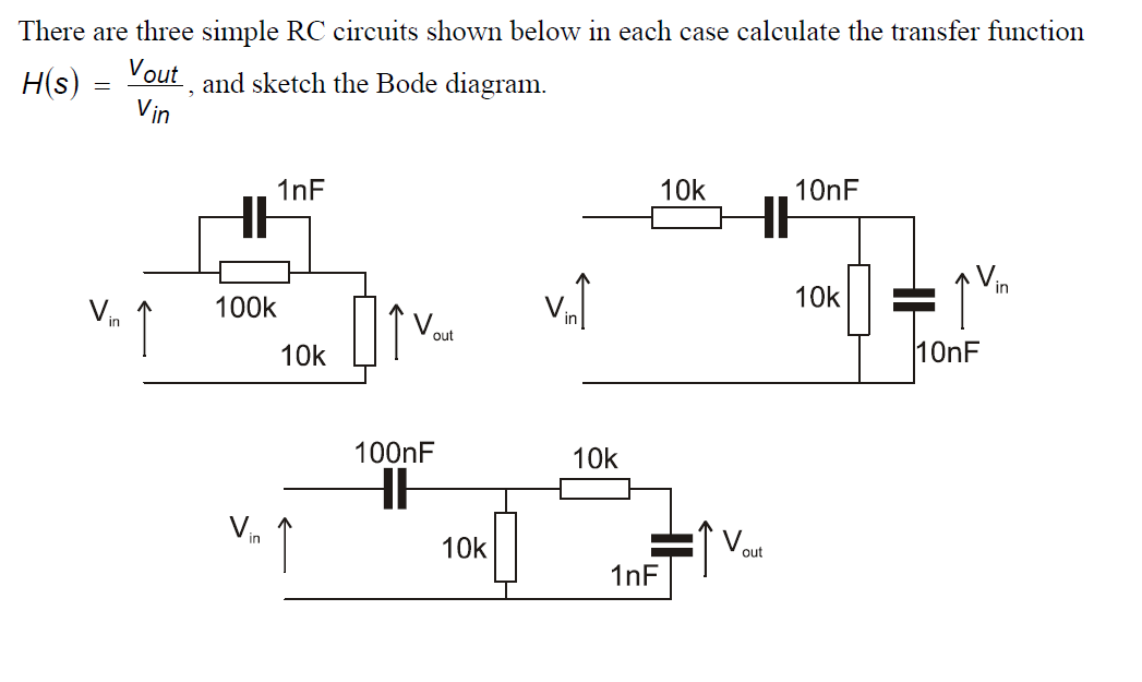

Which circuit? You posted three.
If the first one, I think it has -20dB gain at frequencies below about 16kHz. Above 16kHz it would be unity gain (0dB). The corner frequency is about 16kHz. Upward slope would be 20dB/decade going up through the transition region.
Hey guys, I have calculated the transfer function of the simple circuit attached and also drew the bode plot, can you check if its correct?
Thanks.
It appears that you were trying to do the first one (C=1nf, R1=100k, R2=10k) so we'll do that one first. You'll want to note that the zero and the pole cause opposite sign slopes, one +20db/decade and the other -20db/decade.
The transfer function Hs is:
Hs=(s*C*R1*R2+R2)/(s*C*R1*R2+R2+R1)
At zero frequency the gain K is equal to:
K=R2/(R1+R2)
and dividing numerator and denominator by C*R1*R2 we get:
Numerator: N=1/(C*R1)+s
Denominator: D=1/(C*R2)+1/(C*R1)+s
So we have constant gain:
K=1/11
and the numerator is:
N=s+10000
and the denominator is:
D=s+110000
Thus we have a zero at w=10k and a pole at w=110k, and constant gain -21db.
The two frequencies are 10k and 110k, so we start out at w=0 with the constant gain of -21db which is a straight horizontal line (like you have drawn) and at the frequency of 10k we have a zero so we get a slope of +20db/decade starting at 10k. This continues until we reach 110k and there we have another frequency of 110k which is a pole so we get a slope of -20db/decade starting at 110k, and this added to the previous slope means we again get a line with a slope of 0 which is a horizontal line.
So the plot looks like a horizontal line at -21db that goes from w=0 to w=10k, then slopes upward at +20db/decade, then at 110k it becomes a horizontal line again. Since the slope of the upward line is +20db/decade and it starts at -21db and goes from 10k to 110k, that means it goes upward about +22db and this means we end up at +1db, but the horizontal portion from there is around 0db because since the cap conducts much more than the 10k resistor at infinite frequency, the response is clearly 0db above w=110k. Note that since the distance from the 10k to 110k is really 1.1 decades, we would multiply 20db times 1.1 and get 22db as the rise so this would lead us to +1db rather than 0db. But the quick check with the cap and 10k resistor shows this to really be 0db. So we've corrected this a little by doing that.
Also note that when you get a pole after a zero it cancels out the slope of the zero because the pole has the exact opposite slope as the zero.
So the plot looks like this:
   0                 ------------------
 -21  -----------
      0        10k  110k              +inf

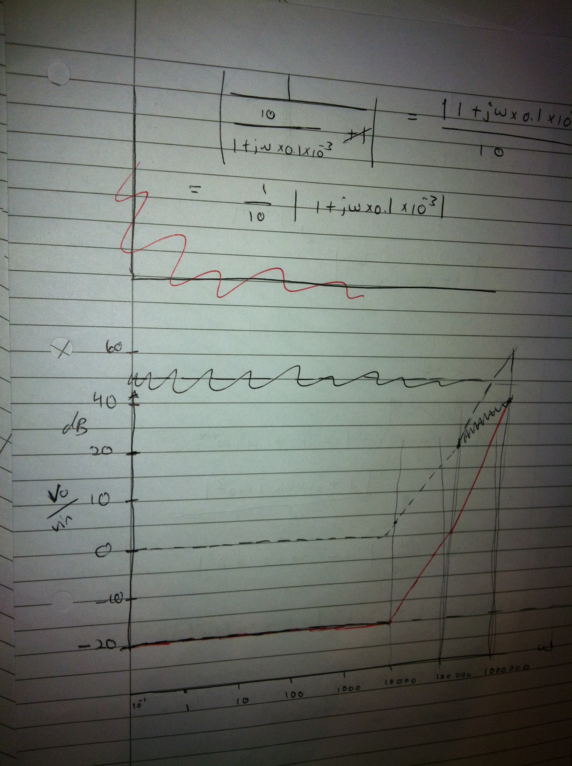

To the questioner:
In order to avoid confusion on your side - just one short comment to the reply from MrAl:
The presented BODE scetch - together with the given explanations/calculations - shows the asymptotic behaviour of the transfer function only.
In reality, there are no "edges" in the magnitude response and the slope reaches +20 dB/dec in one single point only (approx. in the middle of the shown +20dB/dec line).
However, MrAl's contribution clearly has demonstrated the advantages connected with the principle of the BODE diagram:
Approximation of the transfer function magnitude response using piecewise straight lines serving as asymptotes.
Another hint: For such a simple circuit it is easy to find the asymptotes without the need to find the transfer function:
1) For very low frequencies there is a simple resistive divider with Vout/Vin=10/110) >>> -20.8 dB
2.)For very large frequencies the capacitor causes unity transfer >>> 0 dB
3.)The first "edge", which is equivalent to the transfer function zero is reached when |Xc|=1/wC=100k. Therefore: 1/w1=T1=RC=1E-9*1E5=1E-4 >>> w1=1/T1=10k.
4) The second "edge", which is equivalent to the transfer function pole is reached when |Xc|=1/wC=10k||100k=9.1k. Therefore: 1/w2=T2=RC=1E-9*9.1k=9.1E-6 >>> w2=1/T2=110k.
Based on these information it is simple to construct the Bode diagram (asymptotes).

Okay, for the second circuit I am a little confused about how to draw the bode plot. (note there is a typo, the voltage across the second capacitor should say Vout)
My transfer function is:
T(s) = R2C1s/((R1*R2*C1*C2)s^2 + (C1R1+C2R2+C1R2)s+1)
Now I can see that I have one zero at s = 0, and two complex poles at s= -0.015±10j
But you cant exactly compute what happens when w=0 since you cant do log(0) and also how do you deal with the complex poles?
PS: I also dont quite know how you knew that w=10k and w= 100k in the previous question, I mean don't you have to do s=jw and then re-arrange for w?

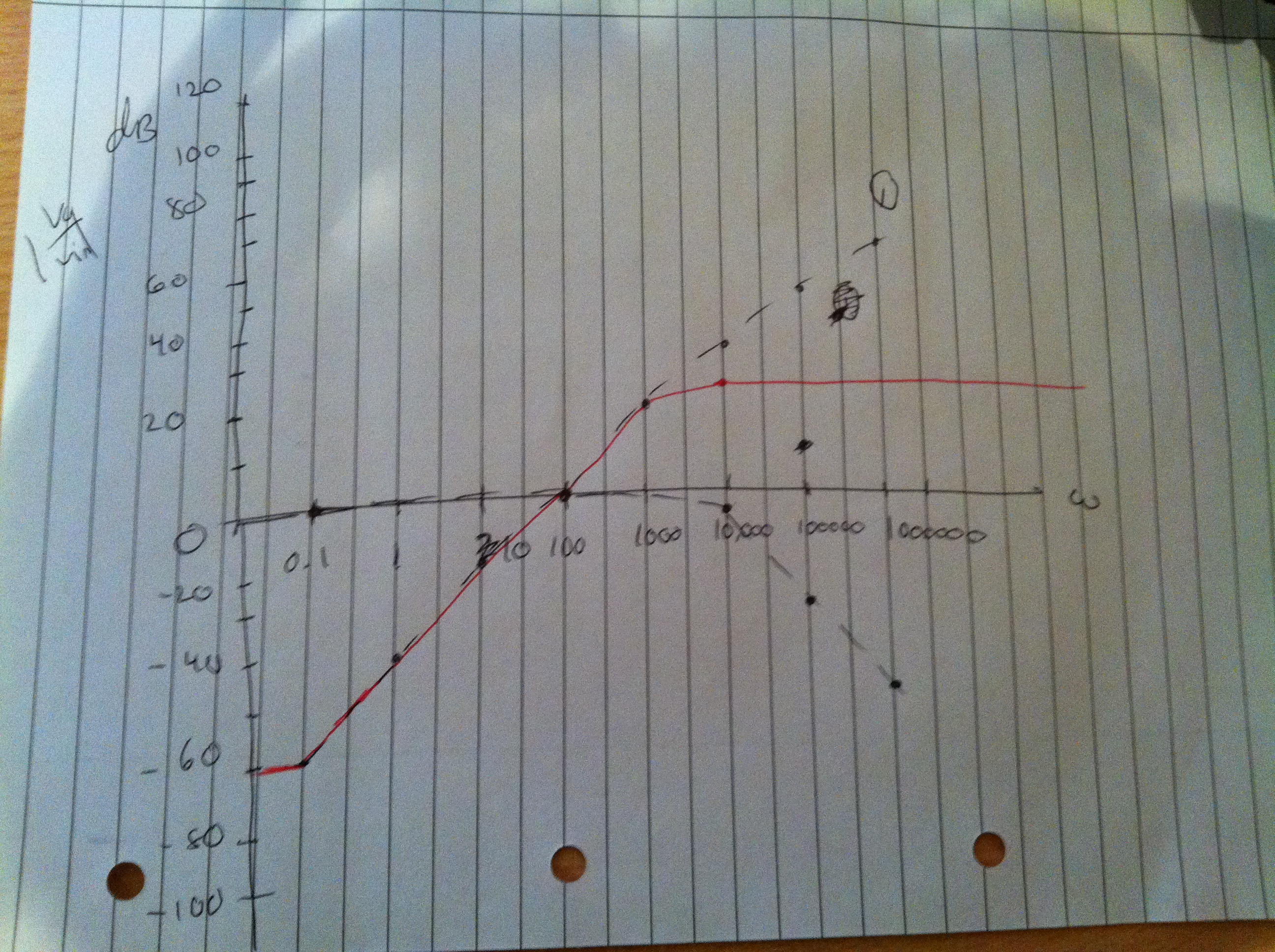

So, I would normally start off with getting the transfer function and then simplifying it as much as possible (put it into the correct form).
In this case I start off with:
Vo/Vin = Rp/ R1+(1/(C1s))+(Rp)
Rp = Parallel combination of the Capacitor (C2) and Resistor (R2) on the output.
In this case, it was easy enough as it simply forms a potential divider and when we simplify it we get the transfer function as shown above:
Also since R1=R2 and C1=C2 it does not really matter what you name the components.
Now, after getting the above transfer function, I need to take it's magnitude's logarithm (in decibels) and compute the result as I change the frequency ω.
So I need to take 20log(|T(s)|).
I split this up in two terms:
1. 20log(|R2C1s|)
2. -20log(|((R1*R2*C1*C2)s^2 + (C1R1+C2R2+C1R2)s+1)|)
Its at this point that I'm stuck. I don't think you can compute the value of the first term since you get a negative value inside the logarithm and the second term gives me weird values/
I don't think I'm approaching it correctly though, since this way of doing it seems to take too long...
Actually wait... the first term will simply be:
1. 20log|R2C2s| = (R2^2)*(C2)*w^2 = 10log(0.0001w^2) = +20dB/dec (when w =0.1, its -60dB)
The second term will be...
2. -20log(|((R1*R2*C1*C2)s^2 + (C1R1+C2R2+C1R2)s+1)|) = -10log((10^-10w+1)^2+(300x10^-6w)) = -20dB/dec (at w = 0, its equal to 0, w = 10, 000Hz its equal to -10 and then its -20dB/dec)
Does this seem right?

Hi fouadalnoor,
it is much simpler than you think.
At first - it is perhaps good to know that the circuit at right (your first posting) is the classical WIEN path with a bandpass characteristic, which is used in the well-known WIEN oscillator circuit.
At second, because it is an RC circuit without inductances the poles cannot be complex - there are two negative-real poles only.
These poles are located at (simply set denumerator=0):
s1=-0.38/RC and s2=-2.62/RC
______________________
BODE diagram: Poles are real. therefore set s=jw.
Mark both poles on the log-scaled w-axis and draw two asymptotic lines with a positive slope (+20 dB/dec) through s1 and with a negative slope (-20 dB/dec) through s2.
That's all. Remember: At the pole frequencies the asymptotic lines always decrease their slope by 20dB/dec. That's exactly what you have done (from +20dB/dec to 0db/dec and then to -20 dB/dec).
The starting point of the rising line is at w=0 with a magnitude of minus infinity, equivalent to the zero of the transfer function.
Regards
Added later: For your information, the third circuit (at the bottom of your drawing) has a similar BODE diagram. It is also a bandpass with two real poles - however, with other values due to other component values.

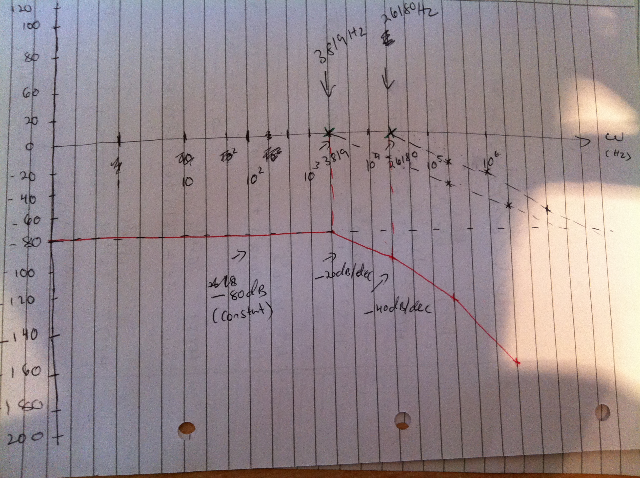

Thank you!
I think I basically got it. From following your calculations I can see that we have one zero at w=0 (does not affect anything) and two poles at w=3819 and w=26180. We also have a constant gain of -80dB (from the calculated value of K).
The way to do it is just turning the transfer function into the appropriate form as you have shown above and then get the gain K with the poles and zeroes that will tell you where you add or take away the contribution of 20dB/dec. (for poles you do -20dB/dec and for zeroes you do +20dB/dec)
The bode plot would look like the one attached.
I just have one question, when you said
"Hs=10000*s/((s+3819.660112501051)*(s+26180.33988749895))
From this we can see that we have two poles one at w=3819.660112501051 and one at w=26180.33988749895."
How did you know that in that form, w = 3819.660112501051 and w=26180.33988749895 for the different poles? isnt s=jw, so how did you re-arrange for w?

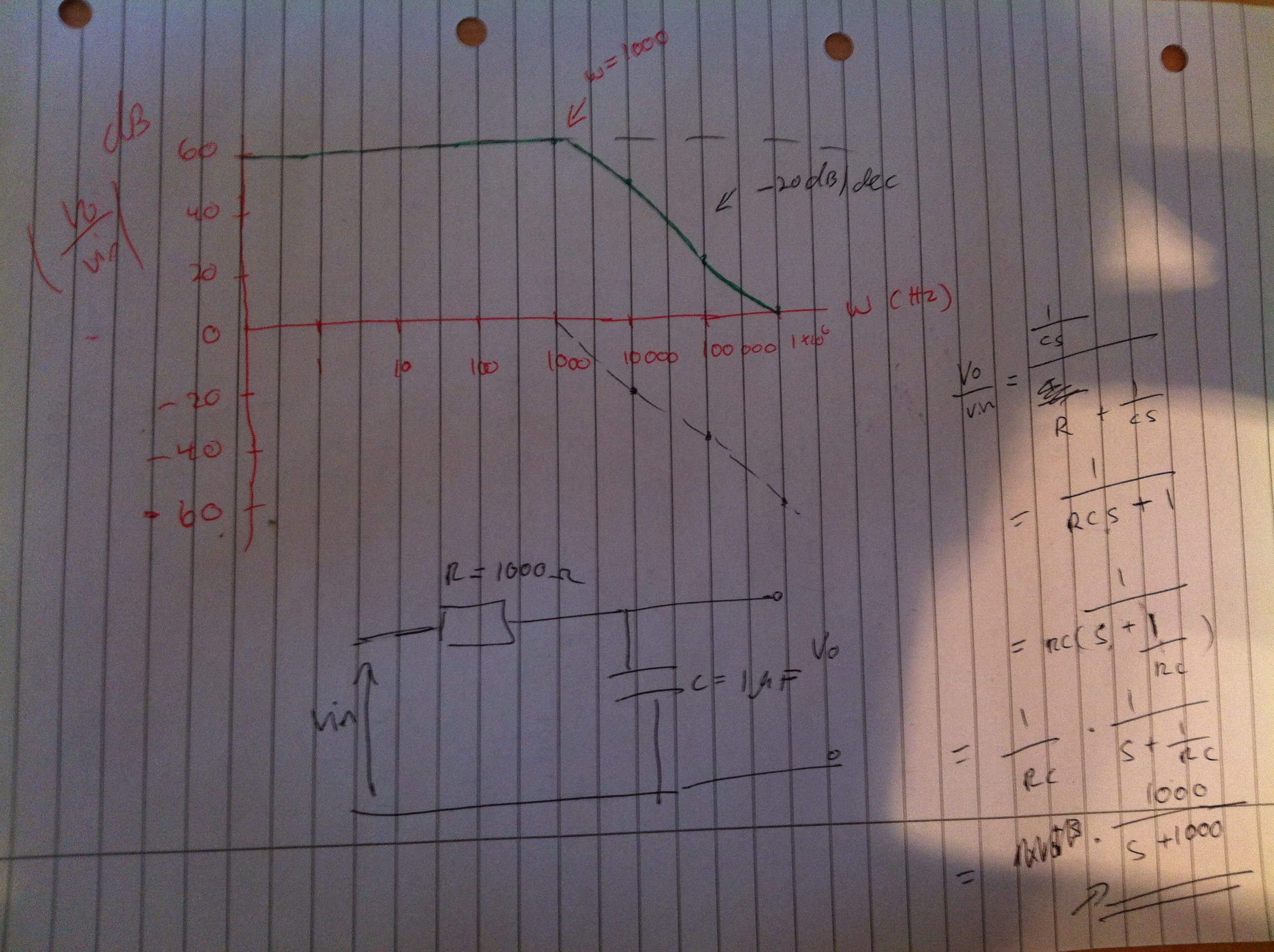

I have now also done an example myself to see if I have understood it all correctly. If we take a simple low pass filter with R = 1000Ω and C = 1μF then we have the following transfer function:
H(s) = (1/Cs) /(R+1/Cs) = 1/(RCs+1)
This transfer function is already in the correct form, but just to make sure that I follow the same steps we did before, I will change it into the following form and find the poles:
H(s) = (1/RC)*1/(s+1/RC)
We know that there is a pole at w=1/RC = 1000Hz.
From this we also get a constant of 1/RC so, 20log(1/RC) = 60dB and we get the bode plot attached.
I do wonder though, shouldn't I have had the constant when the transfer function was in its first form: H(s)= 1/(RCs+1)?
Hi foudalnoor,
I'm afraid, you didn't get it. Both drawings are completely wrong.
I think, you got confused by the constant "gain" MrAl has introduced. For my opinion, you don't need it to construct the BODE diagram
1.) As I have mentioned before, the circuit at right (your first posting) is a bandpass - starting at minus infinity and reaching nearly 0 db at the frequency w=wo=1/RC. The asymptotic lines are touching the 0 dB line, but the real curve between the asymptotes has it maximum at 0.333 equivalent to -10 dB (see my instructions in post#12).
2.) Your second example is a passive lowpass that never can assumes a magnitude larger than 0 dB. What do you think where the gain should come from?
Why don`t you follow my instruction? Simply mark the pole on the log-scaled w-axis and draw a -20dB/dec line (starting at this point).
The other asymptotic line is directly on the w-axis from very low frequencies until wo. That`s all.
3.) I can tell you that the BODE diagram is well-known because of its simplicity. For a first order lowpass you need only one point (the pole frequency).
Oh wow a passive RC filter with a gain of 60db! I love it :)
You might want to included what we sometimes call a 'sanity check' just to make sure you have something reasonable. I mention this because a 60db gain in a passive low pass filter is just not ever going to happen. I cant stress this enough. Once you have the solution, go over it briefly to see if you spot anything that looks like it wont work or is off by a large amount. Maybe it takes time to learn this kind of thing but it's worth thinking about.
You were going pretty good there, with your low pass example. You came up with:
Hs=1/(sRC+1)
and then you divided top and bottom by RC:
Hs=(1/RC)/(s+1/RC)
and you reasoned that you have a pole at 1/RC (of course you know this is really -1/RC). You did very well there.
But now you KEPT that form to figure out the gain, so you of course got the gain 1/RC.
BUT, in the previous discussion, we had to get the equation into the form with the factors (s*tau+1) in order to find the gain K. For some reason you skipped this step and that's how you got the gain of 1/RC, which of course isnt right.
Getting back into the s*tau+1 factors form, we have again:
Hs=1/(sRC+1)
with tau=RC. Now the only thing left in the numerator is the '1', so the gain K is equal to 1.
So try to remember which form is which, and that you need the transfer function in the s*tau+1 factors form to get the gain to stand alone in the numerator.
