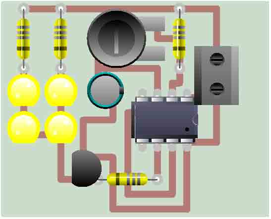

Hi , does anyone have any experience of 555 failure?
I made simple strobe light pcb, which works fine. Then suddenly after if not being switched on for a day or so, it refuses to flash, and just lights the leds constantly.
Does anyone have any ideas what might cause this?
It has happened several times with several different chips.
My power supply is 9v. Im driving 4 superbright leds at 3.8v each @20mA.
I have wired them into two series sets consisting of 2 leds and a resistor for each set, these two sets of leds are then wired up to the collector of a transistor.
I have wired pin 3 of the 555 to a resistor and the resistor to the base of a transistor which switches 40mA (two lots of series leds). I have used the transistor in case of me needing to switch heavier loads in the future.
Thanks very much.

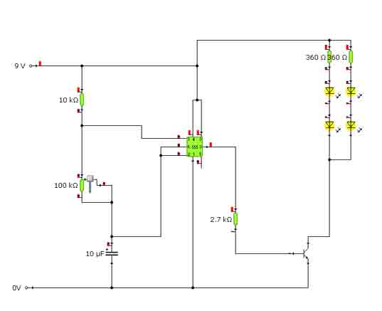

Yup, pin 4 should be at supply voltage. in your case 9 volts dc.
We cannot see all the pcb wiring underneath parts, so why not post the schematic complete with parts values?

A 555 will fail if its load resistor has a value that is too low, causing an output current higher than 200mA.
There is also a limit on how low is the value of its timing resistors.

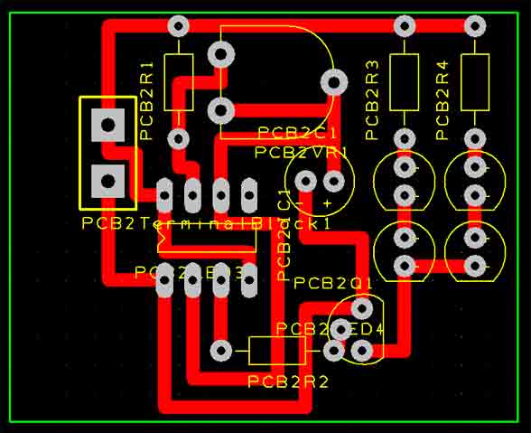

Here is the schematic.

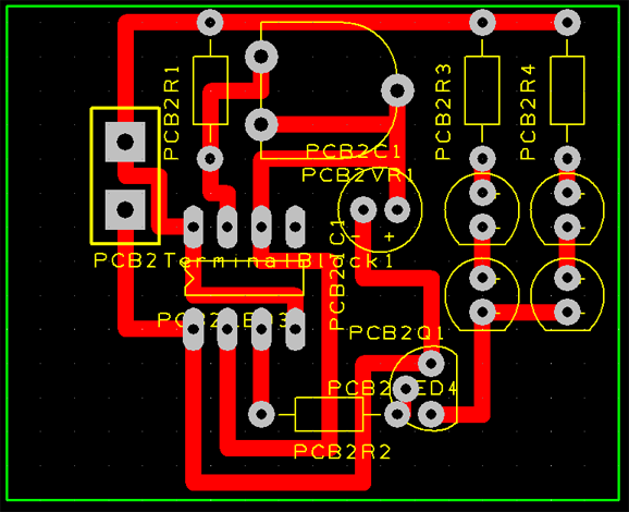

I have also included the pcb layout, before it has been flipped(for toner transfer method).

It is too bad you saved the schematic as a fuzzy JPG file type instead of a very clear GIF or PNG file type because it is difficult to see the pins numbers of the IC.
Is the 100k thing a potentiometer? It should have at least 1k in series because if it is turned to zero ohms then the discharge transistor at pin 7 takes a beating discharging the capacitor as fast as it can and getting hot.
Sorry about my error on pin 4 not being connected. On the original attachment, that just sort of jumped out.
Question: are you using that BC337 NPN transistor in this circuit also? I want to be sure before I comment on your transistor placement this time

I was thinking about that. If I calculated it correctly, the average power dissipated in the discharge transistor at max frequency is only about 0.65mW (6.5mW if the other resistor is 1k, as in his previous schematic). I'm not sure what the high peak power will do to it. Seems to me like a resistor in series with the pot would be prudent, although the datasheet shows the monostable with no current limiter for the discharge pin.

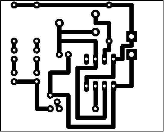

Just noticed, the first picture you posted, its connected up wrong, I assume this is simply an artifact of the software used to create this image, rather than the design itself, as the PCB layout you posted looks just dandy......although that is viewed from the 'component side'. So you were correct in flipping that for toner transfer....if your PCB was clear, you could see that pattern as you look through it from the non-copper side. SO....the first PCB layout (second picture, first post) should be >exactly< what you printed off for toner transfer, as its the mirrored version of the layout.

The first pic i posted, is a flipped view of the one i just recently posted. Its confusing I know, All the components on the first pic are the wrong way around, because they do not need to be flipped, as they will be on the other side of the board anyway. I just included them so you get a rough idea of whats what.

Where's the decoupling cap?
The NE555 timer requires a decoupling capacitor to function.
You have failed to include one in your circuit.
