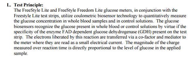

Does anyone know how the test strips work?
I wonder if am ohm meter will test blood resistance with a very small gap of a certain distance between the test leads?
The strips appear to be an electric printed circuit board type strip with a very small gap about .010" on the end.
Before I try to build something for my digital meter I was hoping someone would have information how this works?
I would guess the strips are coated with some special chemical that reacts with the glucose and enables measurement.

This excerpt for the FDA form 510(k) application for your device (required for sale in the US)(http://www.accessdata.fda.gov/cdrh_docs/reviews/K092602.pdf ):
A method based on glucose oxidase is often used as a comparison standard. In both methods, an enzyme is used to oxidize glucose in the blood. The enzymes are quite substrate specific. In the current home-use methods, the electrons lost from glucose are detected as an electric current mediated by FAD as the cofactor. In the glucose oxidase method, hydrogen peroxide is produced which reacts with a dye to produce a color.

I am not trying to duplicate test strips. I was going to build something like a needle point .010" resistance gap then take a ohm meter reading across the gap with blood on the gap. I should be able to compare known blood glucose readings to the ohm meter reading of the resistance gap then draw a glucose resistance graph. Above says, current magnitude is proportional to glucose level. It seem logical this will work. Not very simple for the average person to do at home but if a pre made resistance gap with meter is already setup anyone can use it.

That presumes that the resistance of the blood sample varies predictably with the glucose level, and not by any other factor.
The literature on glucose testing all refer to a chemical or enzyme that reacts to the glucose level. And it is the electrical characteristics of that reaction that the meter measures. And, I'm going to guess that that reaction is a one time process. So you'll need a new quantity of that material for the next test. Also, I'm sure that the exact amount of that material needs to be tightly controlled for accurate and consistent results.
The way I read it, the meter is more a volt or amp meter than an ohm meter. The blood sample and the strip form a little teeny battery.

More like a coulomb meter. Something that is measured with an electrometer. When I worked, I had access to one. I also measured small currents (pA) by dividing by time. It's the integral of current.
Incorrect, above says that the amount of liberated electrons when using that enzyme is proportional to the glucose level. Nothing about current magnitude or even resistance in there.
