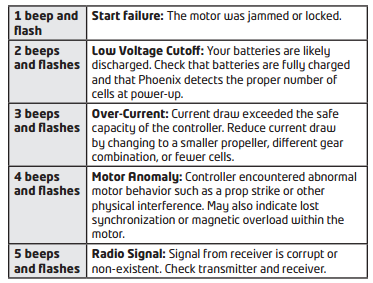

Generally speaking, an esc will not start until it receives a signal that corresponds to the low/off throttle signal, which is often about a 1 mS pulse repeated every 20 mS. If in programming mode, it will often need the high speed signal (about 2 mS) to set the range. You will also set the cut-off voltage; although, some come pre-programmed for that variable. After setting the high range, you then return to low speed or power off to start the motor. When you power up, the signal on the esc input must be the low speed/off signal pulse width. Modern esc's will not start with power on for obvious safety reasons.
Here is a snippet from a Castle Creations manual:
A simple way to get programming done is to use an RC transmitter and receiver. Another way is to make a simple servo driver based on the 555 chip. There are many designs for such drivers.
