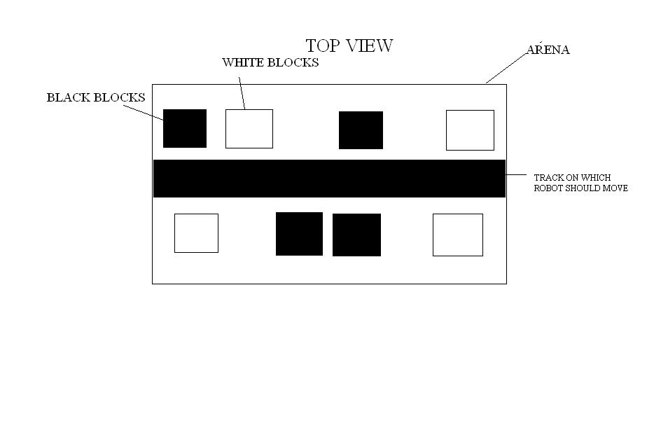

Can you draw a picture (even in MSPaint) of the 'track' along with the placement of the black/white blocks. What colour is the 'track'...black, white or other?
Is the robot simply following the 'track' and lighting an LED when it discovers a black block?
How is the robot being guided around the track?
I have attached the rough figure of the arena.....the robot is a line follower type which has to follow the black track, which can be easily done using IR sensors feedback to DC motors.....but it has also to sense the black block n indicate sensing via visible LED....here the problem lies.

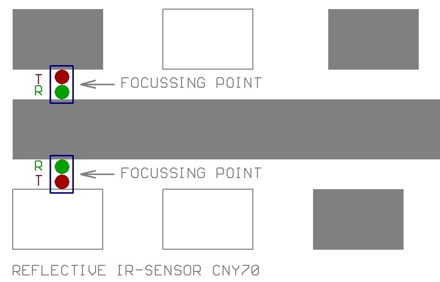

I don't see any problem there. The line to follow is solid black, interrupted by a white area right and left of the track. White and black blocks around the track are of no interest at all - as well as the black track itself.
Focus the two IR reflective sensors on the white strip next to the track. If ever the IR reception is interrupted (leaving the centerline) you must apply an opposite steering command.

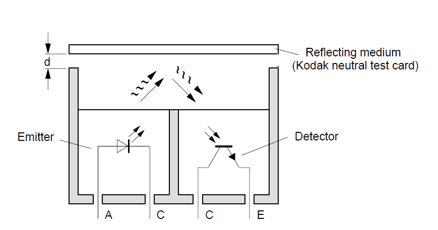

The CNY70 would suit perfectly for the task. Arrange the sensors according to the datasheet as close as possible over the surface. Make them adjustable in height for optimum line following.

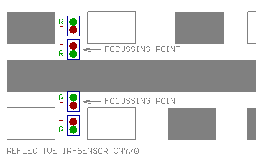

Use the sensors close to the centerline to keep track. Use the outer sensors to flash an LED, count the black areas or whatever is the task.
Arrange the sensors a way that even if the vehicle is off track the black areas will be "seen".

there are crossings so you may need four sensors at all four corners of the bottom to track the path.
there are turnings so the distance of the cube may vary slightly, try to get maximum and minimum distances during this by the data provided, then you should make sure the sensed LED doesnt turn off before it passes the block.
consider at curves there wont be any perpendicular surface to reflect perfectly when passing white blocks. thus some fine tuning of sensitivity is required.
at gaps the field is too far, and can be recognised as black block, so you may need two types of sensors here, one is to detect there is an "object" and another one is to detect "no white surface", when both occurs at the same time only it should indicate sensed.
so both side of the robot will have to have 2 sensors, for both object sense and for intensity/colour sence.
