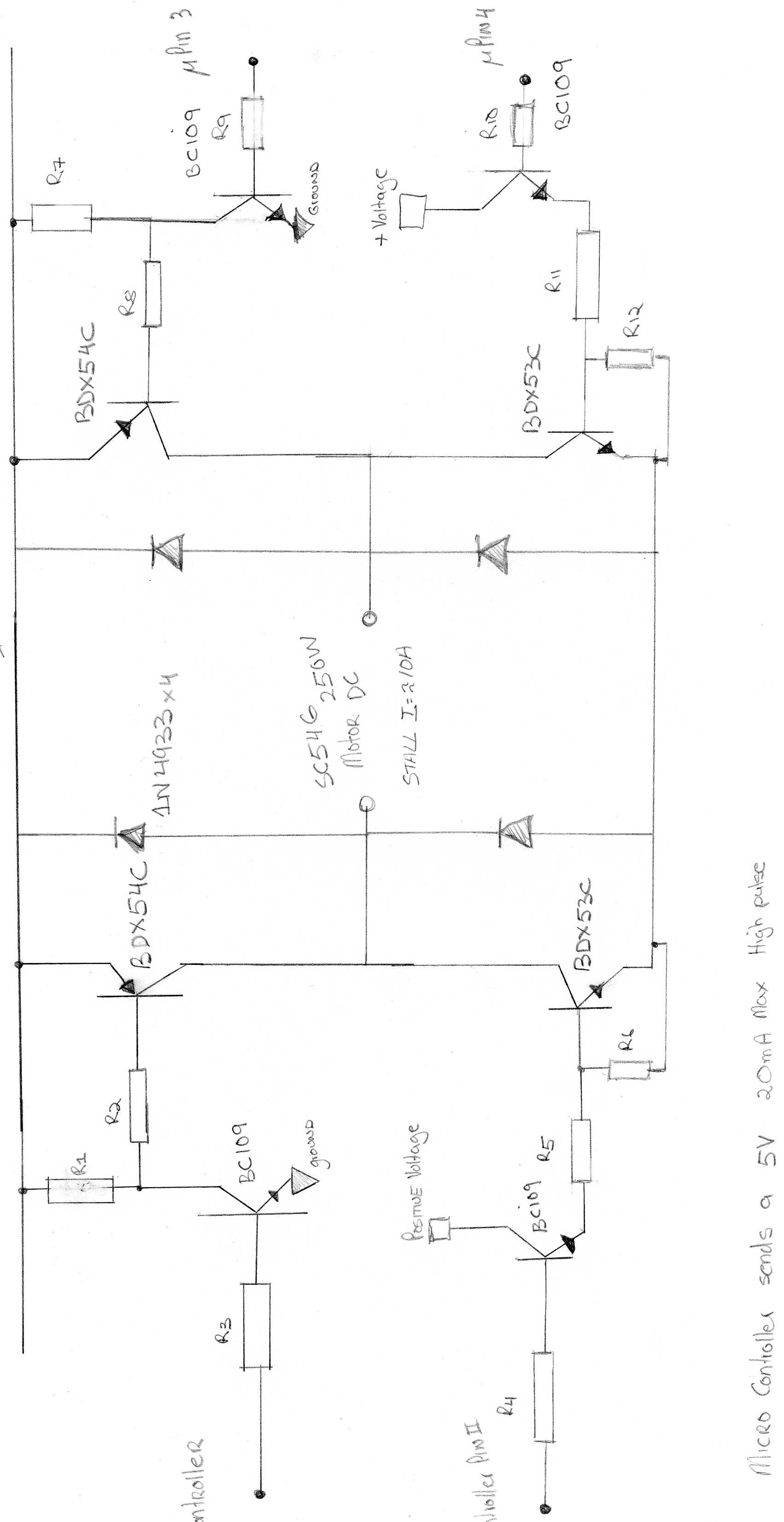

hey guys:
Any transistor guns out there ??
i have been trying to design a h-bridge using BJT transistors to operate a DC motor at 48 volts. The control circuit is already finished. I am using/ well plan to use, a microcontroller with pulse width modulation to control the speed of the motor. But i cant get my H-bridge to work at all! in particular i have almost no idea in working out the Resistor values of my bridge.
I have posted a picture of the design. if anyone can step me through the design process it would be much appreciated.
Heres what i have done so fare. :
given that i want to run 48 volts to the motor but which to switch it on with a 5b high from the micro controller, i have chosen 4 darlington pairs! BDX54B and BDX54C, these npn and pnp transistors have a Vceo of 80 volts! so i know they are a good choice. furthermore they have a Hfe minimum value of 750.
for the Motor that we are running i calculated the Stall current to be 10 Amps. so from this i worked out that i need ten amps in the collector of the top left transistor (on the drawing) therefore i calculated R2 to be
(48-0.4-1.7)/R2=10ma (given the Ib Ic relationship) hence R2 to be 4.6k is this right ?? if not how do i calculate the resistor values throughout the circuitry to get it to work ??
the idea is to have four output pins of the microcontroller which sends 5v high (20mA) or a 0 and in that way engage forward and revers for the motor!!
the bottom transistors i'm using are BC109s though i think there not suitable given that only have a vceo of 45
can anyone help me ??

Have a look at this method.
I would suggest that you cross link the drive transistors
ie: top left darlington with the bottom right darlington, likewise the top right and bottom left and electronically interlock the two motor drive paths so that they cannot be turned on at the same time.
In your present configuration an accidental condition could arise where the top right and bottom right darlingtons could be ON, causing a short the darlingtons. As could the other pair.!
The added advantage it requires only two PIC pins not 4.
Does this help.?:)

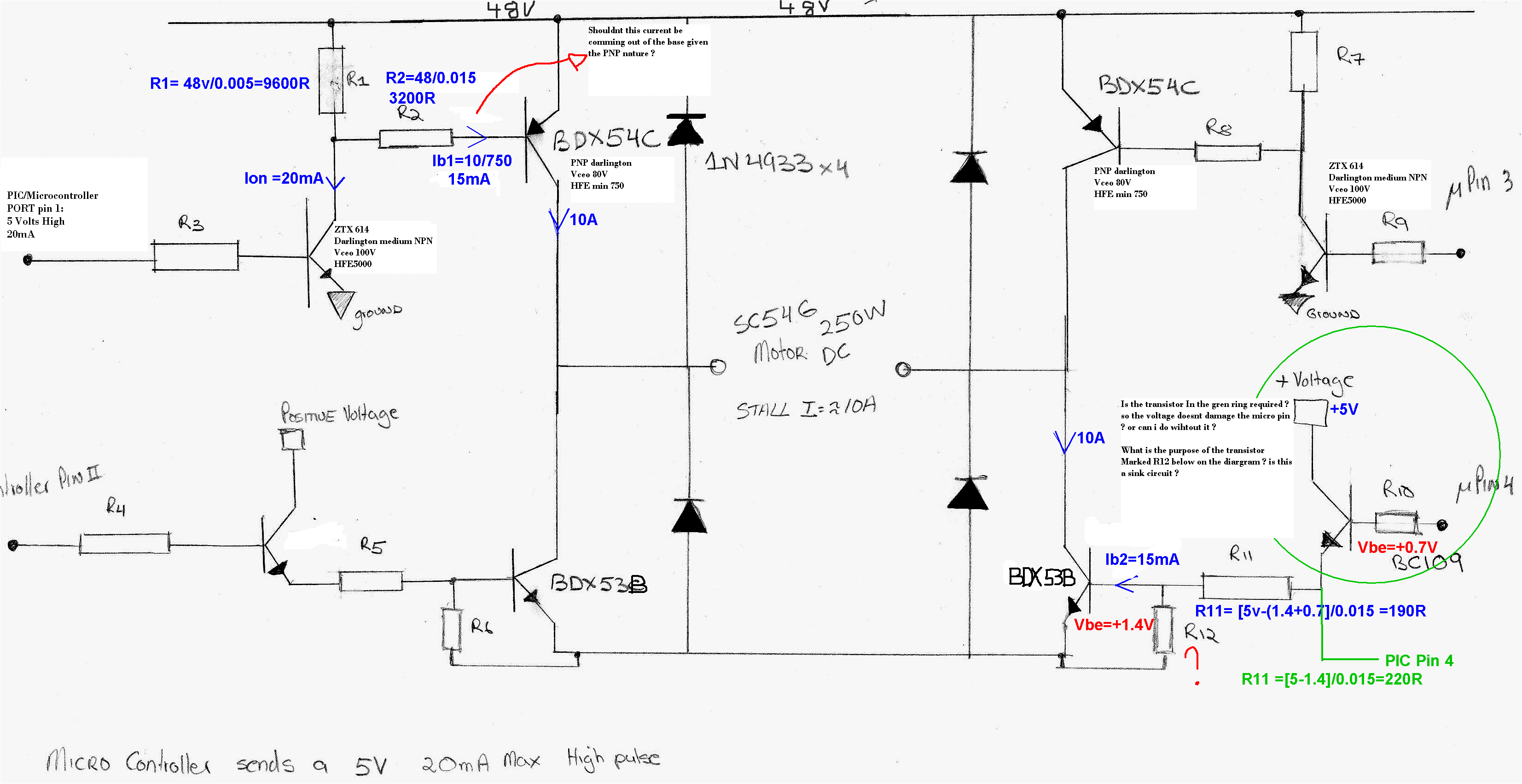

hi chuck,
Look at this modified drawing, why do you think the 'green ringed' transistor is required.?
Does this help.?
This is not a correct statement, the PIC can supply a current of upto 20mA into a load from the 5V ideal output.
So the minimum load resistor to 0Volts, on a pin should be <= 250R

thanks for the help:
I though i would need another switching transistor to turn the NPN in the green ring on, at the same time that i turn the top right hand corner on ?
the 2n2222 npn will that be strong enough ? it says that the Vceo is only 30, now I'm using 48V so i think i wont lose 18 volts in my system so the voltage could blow this transistor ?
also how can the Collector current of the 2n2222 be the same as the base current at R3, from the micro controller?
the green ring
i thought i needed to switch on the darlington NPN in order to get hte system to work ?? like send a signal from themicro to pin one and pin 4 ?? is that wrong ?

Look at the ZTX [651 or 653] series of medium power transistors.
They are not the same, R11 with the BC109 emitter follower is 190R and R11 is 220R direct from the PIC..
the green ring
The darlington only requires about 15mA, this will switch ON the darlington, the PIC can output 20mA.
Do you follow the rest of the explanation.OK.?

to clarify something , the green ring shown on the bottom right hand side, a modification you showed. The reason i was using two transistors, the Darlington and the switching transsitor was because i was worried that the full 48 volts would interfere with the Micro (pic) and blow the pic ? is this right ? because i see you have connected the Micro directly to the Darlington?
and one i have one side working (because im bread boarding it tonight) is it safe to assume that the inverse condition will have the same resistor values right..? cheers eric
The PIC pin never 'sees' the 48V's on the BJT collector.
The forward Base to emitter voltage drop across a single transistor is only 0.7V, for a Darlington its about 1.4V.
Via that base to PIC pin resistor.!
Thats correct, I have only shown one diagonal of the HBridge, they are identical.

Progress thanks to Eric !
here are some questions attached to the diagram.
also should i think about modeling this on pspice first to see if it works ? is that possible ?
and, can i control forward and reverse by sending highs to pins 1 and 4, and 2 and 3 respectively? thats the idea right ?
I dont use Pspice, I'm sure someone will tell you.
You have to switch ON the top left and bottom right at the same time for one direction and the top right and bottom left for the other direction.
NEVER both diagonal BJT pairs at the same time or you blow the BJTs
Do you follow.
I did say earlier you should electronically interlock the BJT's so that the incorrect paths thru the BJT's cannot happen..
EDIT: R6 and R12 should be about 4K7 to 10K.

do i need that extra transistor? in the ring ? or should i hook it up straight to the micro ?
No,,,, Yes
via the base resistor.
GOT it working!
thanks very much for your help ERIC!
I changed the design significantly! modifying the power supply to 36 volts,
i will post the complete design with calculations soon! But it works perfectly! even with the PWM!
