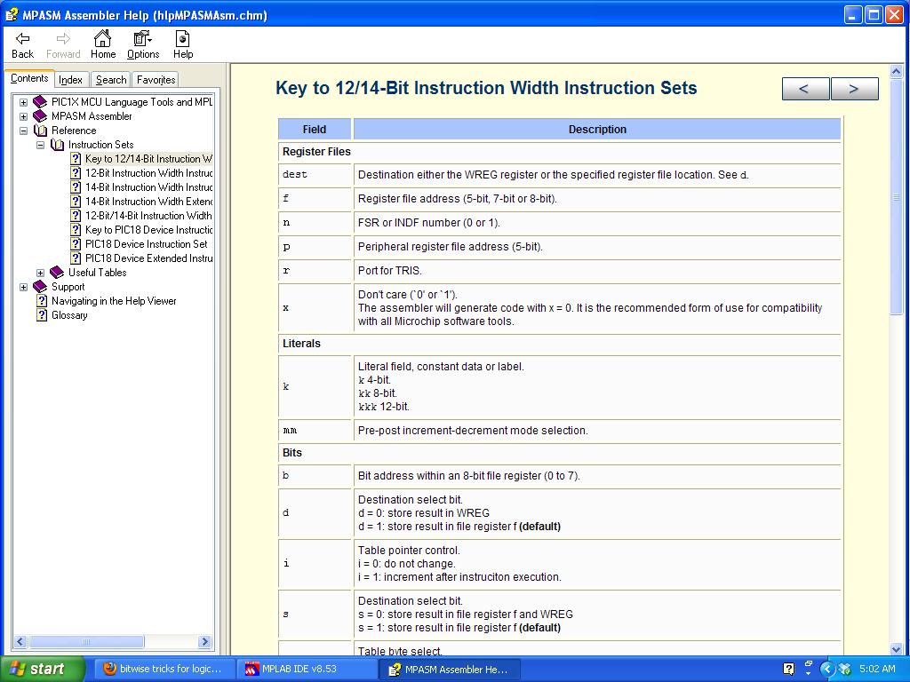

It's all logic You can learn a lot reading mplab mpasm help files. You just got to think like a pic. How can i do that with a 0 or 1 And Mike and Nigel are both real smart cats I would just like to no half what they Know. I learned a lot from both of them.

zhaniko93 maybe we both learn some English this year and be great writers Ps. I hope you like the pickit2 clone you'll have about January 10th. Good luck with your coding. Oh read about logic chips and how they work and asm will be easier to get a grasp of.
Great stuff to read attachment
