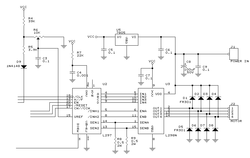

Just use your 4 wires that switch to go to your 4 outputs and do use
protection diodes.
Put your diodes on there like this

AAARRRRGGGGG ... What is it with the hobbyists' love affair with that dinosaur dropping?!? Use a FET based IC that has synchronous rectification built in!
That is a unipolar motor, the extra two wires are the center taps so you do not need to use a bridge. If you want the full torque you can still use it bipolar if you do not mind the complexity.
