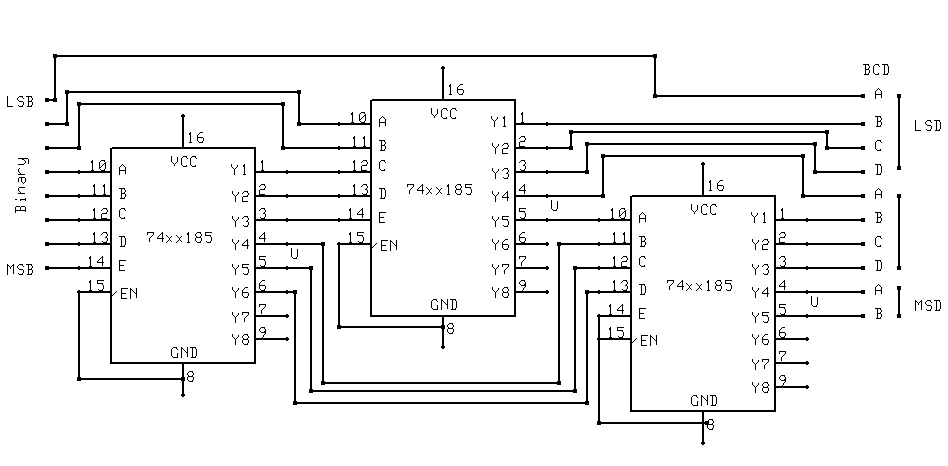

i need a binary to bcd converter circuit for my design project. not using programmable ic's. :D
This do?
