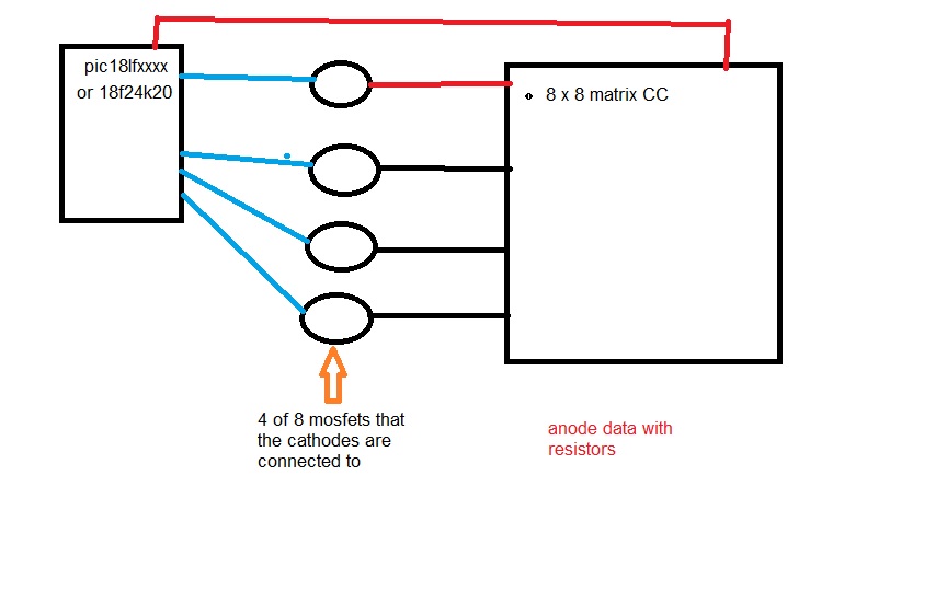

basic idea I am contemplating is an 8x8 led matrix that I scroll data across but the display shimmers or sparkles or what ever you want to call it.
hopefully utilize an 18lf2420 or 18f24K20 as the matrix will be coin cell powered. Using PWM I only have 2 port pins available if I interpreted the data sheet correctly thus the concept of BCM.
All 8 cathodes controlled by mosfets or transistors.
Another Idea I had was just blinking the cathodes at a variable rate, each cathode line at an independent rate. A crude method but might be easier to use.
It would be the KISS method. turn on each cathode line say DELAYUS(50 to 400) estimate
You're going to use a coin cell to light 64 LEDs? You're battery life will be truly astonishing.
not all the the same time. I designed n assembled 6 boards w/ 1-32mmx32mm matrix, 1 18f24k20, nine resistors all running on a coin cell battery. 6-10 hours run time. This design will be a DIY 8 x 8 matrix using smd, mosfets on the cathodes so I hopefully can make the display "twinkle" as the data is scrolled across.
Remember this is just a crossed fingers concept of an idea. Maybe it won't work but then maybe it will??

This project may be going south as I have a basic pcboard layout but all canot fit into desired board size.
Thus I either need to go with smaller footprint components (using 1206 resistors and similar smd leds.
So a this juncture, we will end this thread.
NOTE the final project is led matrix ear rings or lapel buttons so size and weight have alo to consider.
Consider using an LED driver chip like a MAX7219. It will handle an 8x8 matrix with only one resistor and a 10uF capacitor. It uses an SPI interface so it requires reading and following the data sheet. You'd need to use a higher voltage power source.
