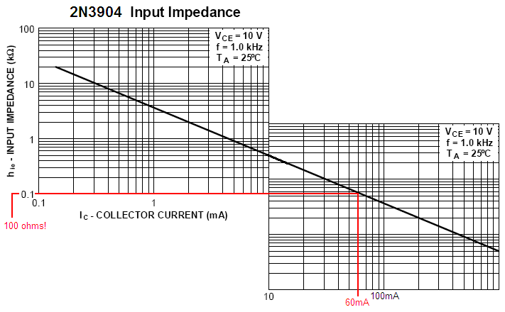

The input impedance of a common-emitter transistor stage with its emitter AC-grounded could be as low as 100 ohms if its collector current is about 60mA. It is less than 2k ohms at a few mA.
1.What is the role of f=1KHz and Vce = 10V if it changes with the signal frequency then what should be the design frequncy for input impedence?
2. In books they say that input impedence can be taken as hFE times emitter resistance then why to use this graph :?:
The 1KHz is simply the frequency that graph was plotted at, it doesn't say it's frequncy dependent, although it will be to some extent. 1KHz is just the standard frequency for audio measurements.
Audioguru clearly pointed out the graph was for a transistor with a decoupled emitter resistor "common-emitter transistor stage with its emitter AC-grounded". So that formula doesn't apply.
