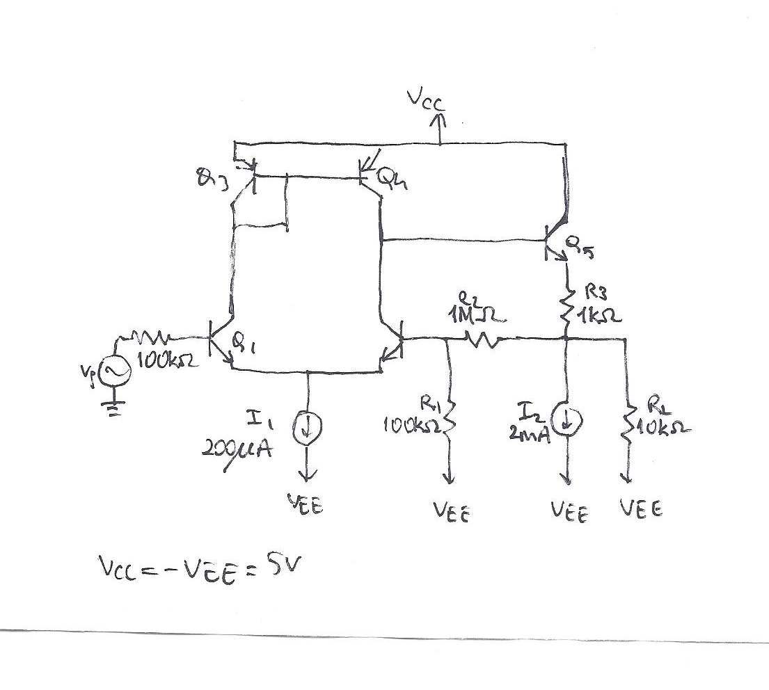

biasing, please help
jigsaw55
hi
here, output voltage is VRL.
how can i find emitter current of Q5
help please it s urgent..

The amplifier circuit with negative feedback will try to keep the output DC output voltage at the same voltage as the input which is 0V.
Then the 10k load resistor has a current of 5V/10k= 0.5mA.
A tiny amount of current (only 2uA?) is the base current of Q2 which can be ignored.
Then the emitter current of Q5 is 2.5mA plus its small amount of base current (maybe 20uA) plus the 2uA.
so thank u , one more question .... is there any more analyitcs way or analysis already begin with assuming Vo=0 DC.?

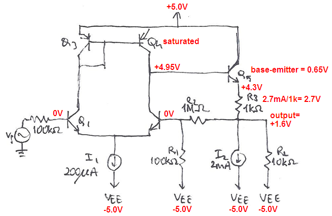

Sorry, I didn't notice that R1 connects to -5V instead of to 0V. Then the negative feedback through R2 will make the output voltage as high as is possible which is about +1.4V. Then the emitter current of Q5 is about 2.75mA.
sorry but i cant see the point. feedback wants to keep output equal to input ok .. but there are 2 inputs here..we set them 0 for dc then I m confused :S ..May u explain with math process, please?
The input at the left side is connected to 0V through the 100k input resistor and signal generator.
The input at the right side has a 100k resistor to -5V (-50uA) so the output into the 1M negative feedback resistor R2 will try to go to 50uA x 1M= +50V.
The output cannot go to +50V so it goes as high as it can which is about +2.7V.
The math is simply Ohm's Law and addition.
ok i see it cant be 50V , but where the upper limit 2.7 comes from i didnt find...do u assuume VBE=0.7 or something... i m sorry to busy u
Here is how I calculated the voltages (without including very small bias currents):
