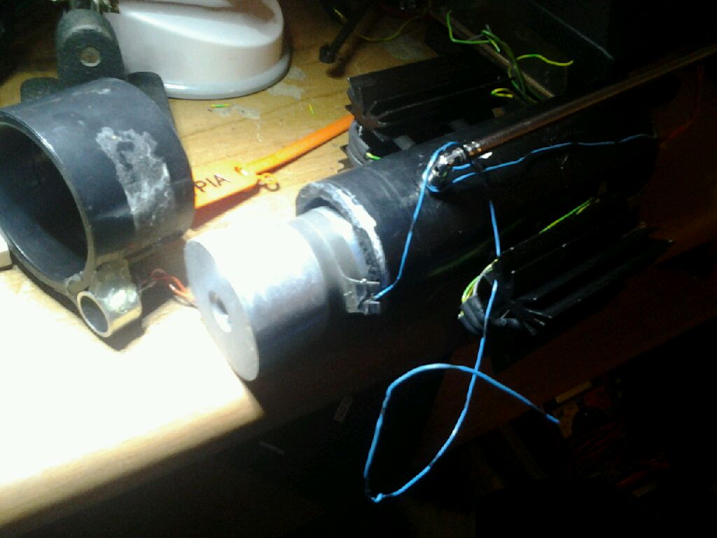

i don't get all that parallel speaker(transducer) stuff yet, so for learning purposes ima try this to see if it works, although i don't got the horn thing figured out yet: ) latest_attachment.jpg
