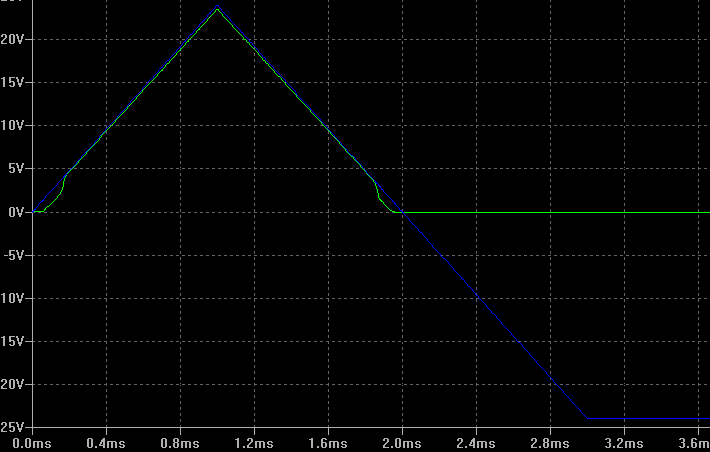

Hi Jst3712,
A circuit like this could do the trick.
When you look at the graphs you can also
see the limitations of the circuit.
It won't work below 5 volt and the load
current should not exceed 500 mA at 5 volt.
You could replace the old dog with a more
expensive logic level mosfet.
The same goes for a high load current, even
when the supply voltage is well above 10 volt.
Because the Rdson of these old fets is far
higher than those of modern fets the voltage
drop across the Rdson will become significant.
on1aag.

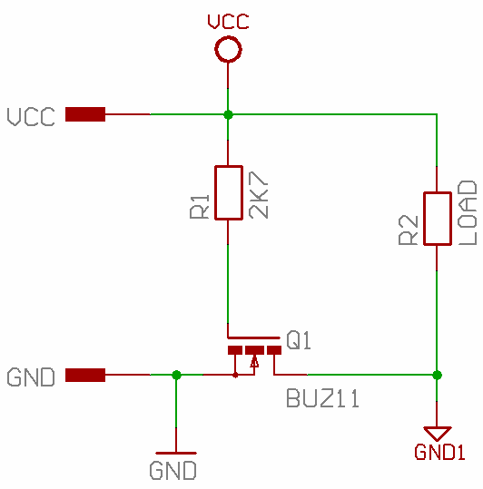

How about that?
I haven't tried it yet (no N-Channel MosFet at hand), but it should work.
There are two conditions which must apply to have the transistor conduct. There must be a negative or neutral source voltage and a positive gate voltage.
The transistor has less voltage drop than a Schottky diode.
Boncuk

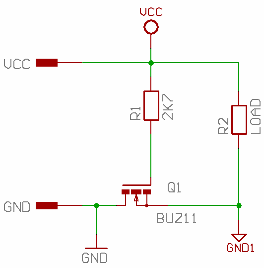

It won't.
Under reversed supply polarity, the MOSFET is not biased ON but the internal parasitic drain-source diode would conduct and power/destroy the load.
However, if we swap the drain-source connection, then it will work.

It won't.
Thanks,
just forgot about the internal diode. ;)
