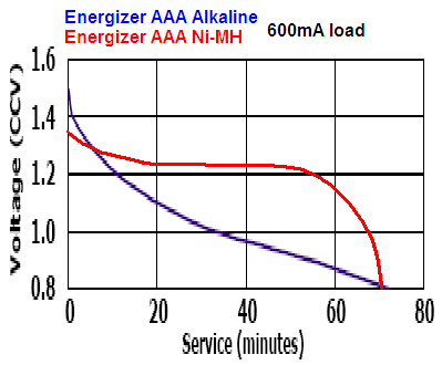

The voltage from alkaline batteries drops like a rock and so does the brightness of a simple flashlight.
The voltage from a rechargable Ni-MH battery begins lower than alkaline but the voltage stays much higher longer. Then you can charge it and use it again many times almost for free.
Agreed. I should have mentioned that.... you need a regulator to drive an LED from alkaline. Since the LED relies on current rather than voltage as the prime driver for ratings and for brightness, it is ideally a current regulator.
NiMH has a flatter voltage curve, which is also a solution, with careful design (resistance choice).
I was assuming he was talking about using NiMH batteries and yes I don't think 2200mAh NiMH cells exist, I think he was confusing them with AA cells.

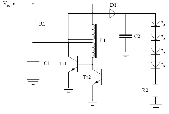

Here's a simple constant current LED boost converter. I modified it from a simple boost switching regulator. Efficiency is typically around 60% to 80% but you can probably make it even better if you know what you're doing.
R1 = 10k but it needs to be less than that for higher power levels.
R2 = Current sense resistor.
C1 = 4.7nF
C2 = 100:mu:F
D1 = 1N4001 but a schottky barrier is better.
Most small NPN transistors will work for Tr1 and Tr2, 2N2222A, BC549 etc. but check the power rating.
The problem is the voltage drop of the diodes needs to be more than Vin or else the current from the power supply will flow though D1 and destroy the LEDs.
C1 = 4.7nF
C2 = 100:mu:F

The output voltage is simply the forward voltage multiplied by the number of LEDs. This circuit is most efficient when the output voltage isn't much higher than the input voltage but you want to ensure that the output is never below the input so you do need a reasonable margin for error. Yes, four banks of three is probably ideal, and six cells will give 7.2V which would be perfect.
The current supplied by the battery isn't the same as the current used by the LEDs if you're powering them from a switching regulator. If you're using a step-up converter then the battery will always supply a larger current than the LEDs are using and if you're using a step-down converter the batteries will always supply a smaller current than the LEDs are using.

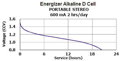

Energizer's alkaline D cell is 20,500mAh if the current is only 25mA and if the end voltage is only 0.8V. The voltage keeps dropping and dropping and dropping and dropping and dropping and dropping.
With a 600mA load and lots of breaks to rest, it is only 9600mAh down to 1.0v.
As far as I'm concerned, flashlights are used for emergencys (or to see). Power Outages only last for a hour at max, So this should last a long time.
