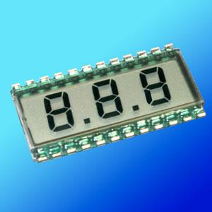

While of course you are quite correct, us engineers will go to silly lengths to remove any components from a circuit, I sometimes wonder why they dont do an lcd with a pic micro controller that you can use to control other things as well, then you just strap an lcd on and away it goes.

microchip has come close to this. They have a few PICs that have the LCD driver on the chip. Just hook it to some LCD glass (lcd no controller) and bob's your uncle. The drawback is it takes a lot of pins to drive LCD glass so these then to be SMD parts.
Interesting, I'll look at that.
Makes sense though you see plenty of commercial stuff such as car radios where the lcd is connected directly to the micro, from what I know dc is bad for lcd's
There are a few projects where people use a normal micro PIC AVR etc to drive a LCD with the required AC. The difficult part is getting enough pins and that some LCDs require a low voltage, so you have to run a low Vdd or some way to reduce pin voltages.
i have used an lcd, way back, it was a 7000 or something like that series chip which was a freq counter with a built in lcd driver.
The data sheet banged on about ensuring there was absolutely no dc on the display otherwise it souldnt last long.
As I understand it ac squarewave is applied to the backplane and ac is applied to the segments, in phase for segment on, out of phase for segment off.
