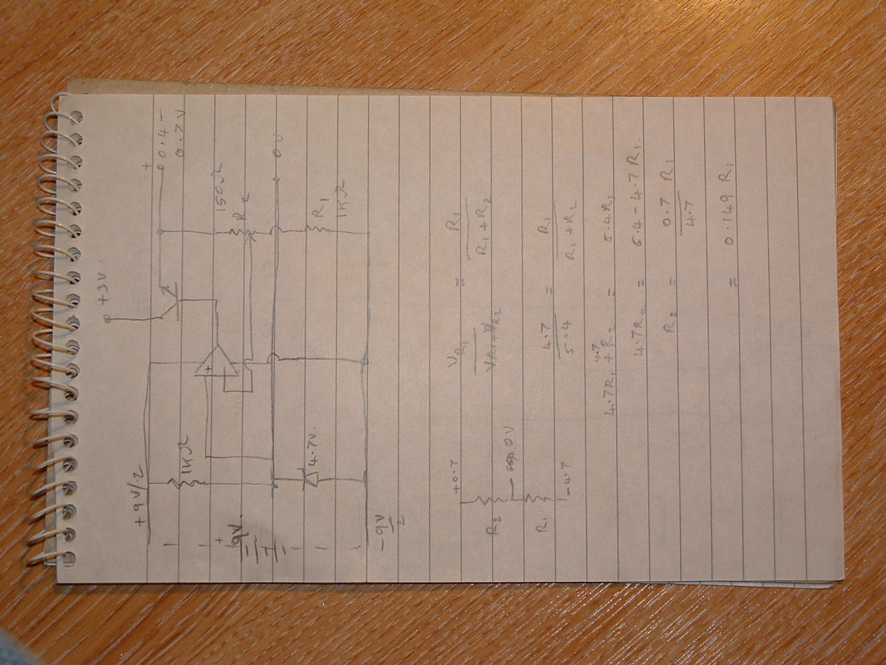

While my HP power supplies can do this with ease I need a portable solution on board. I need anywhere between0.4V and 0.7V, depending on the voltage it will need to be able to handle upto a max of 1.A.
I cant go above 0.7V under any circumstances, so how best to do this and keep the voltage stable? Its a add on for my project so I cant say yet why I need it (Not helpful I know), what I can tell you is the voltage is for a chemical process hence why the upper limit, if I go above this limit then the process wont work.
I have had it working perfectly with a decent power supply, but it isnt mobile! Its only now that I am assembling the final project that it suddenly hit me that 0.7V might not be so easy to do.
A couple of ideas come to mind, neither are very energy efficient but far better than nothing.
Use a typical series regulator circuit with a zener for reference, an op-amp for control and a nice chunky transistor as the pass element to control the voltage.
I suggest either a rail to rail op-amp, or use a +/- supply for the op amp so that it can control down to zero volts.
Use a big low voltage battery (portable ?) say 3v for the supply to the pass transistor, and a separate higher voltage supply (9v battery) for the op-amp.
Or, you could use a shunt regulator circuit with maybe a power MOSFET as the shunt controlling element. Again using an op-amp etc for the controls.
As I have been writing, I vaguely remember a variation of the LM317 circuit which can control down to near zero volts. I am not sure without going searching whether it could be made to handle 1.5 amp.
Weight wise I can use maybe upto 4 P9 batteries, the high current isnt constant, its more the peak limit. I didnt think of opamps, maybe because the rest of the project is all micro etc and I overlooked the obvious!

Thinking about it some more, I could maybe drop the current to 1.2A. But that would be the absolute bottom as I have to allow for the initial spike, the spike lasts around 100ms worse case.
I quickly scribbled this to show the idea for a series regulator.
Thanks Jim I will sim that :D, where would it be best to put a ten turn pot for fine adjustment? I might need to think about some way to monitor the battery voltage, at the moment I dont know if its needed as I dont know for sure how long the runs will be.
Before I build anything else I need to find out why my ATX bench supply has just started throwing bad ripple! That or I might just add some caps for now :D.
R2 is a variable for adjusting the output.
If my quick calcs are correct, with the values shown it will adjust from about 0v to about 0.7v
Cheers Jim, I am on the ipad so the screen isnt picking up the detail well, I will fire up the laptop so I can read it better.
Sorry it is a quick pencil sketch which does not give a very good pic.
Thanks Ron. Its fine on the laptop Jim, the ipad is alot brighter and it can be hard to see detail on it. All I need to do now is try and sim it, I am determined to learn this program!

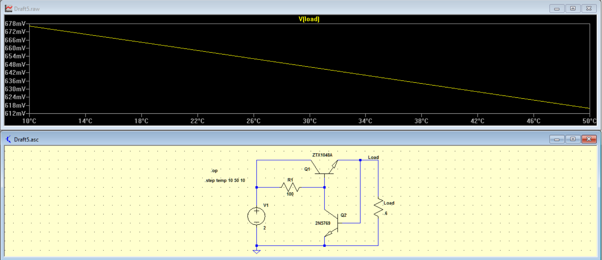

2 hours at a time is ball park. The other thing I need to watch for is stability over temperature, the device will start at around 10C but the temp will rise ~30-40C.
So I am wondering if a ref voltage would be an idea? I start to get Chlorine of NOx or other nasty fumes as soon as the voltage rises above 0.7V, maybe if I set the voltage a little lower and let it rise to 0.7V once the ambient temp has reached its maximum.
Sorry just thinking out loud! This is another reason to learn spice!! If I get this working well then I might build a slightly different one for use in a Chlorate cell.
Not sure how stable the voltage needs to be, but even a silicon diode might be good enough as a sub-0.7V reference?
Is this too simple?
Is this too simple?
I think as long as max voltage isnt exceeded then apart from a loss in efficiency (I can live with that) all is good. My main concern is the 0.7V is not exceeded as its gets really nasty very quickly. I am slowly going through LT spice tutorials, got its boring!! And having trouble finding many parts to sim!!

I picked a random rail to rail opamp in spice, but I am unsure where to put the earth for the sim? I was going to put it between the two batteries but somehow that dosnt seem right!
The other question is, is there a variable resistor in spice or do you just tell spice to alter one of the divider values by x increments during the sim? Sorry for noob questions but spice is new to me although it appears pretty good fun :D
