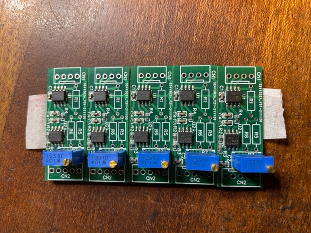

Example - these cost less for the boards and assembly than I could buy the parts alone for in the UK:

One note about the assembly service - you basically pay the cost to make the blank PCB and the cost of the components. You save the cost of a solder stencil, with is basically the cost they charge for the service. The service is based on buying 10 boards, so you're paying for the cost of components for 10 boards, so the price can add up, even though the service is essentially free.
