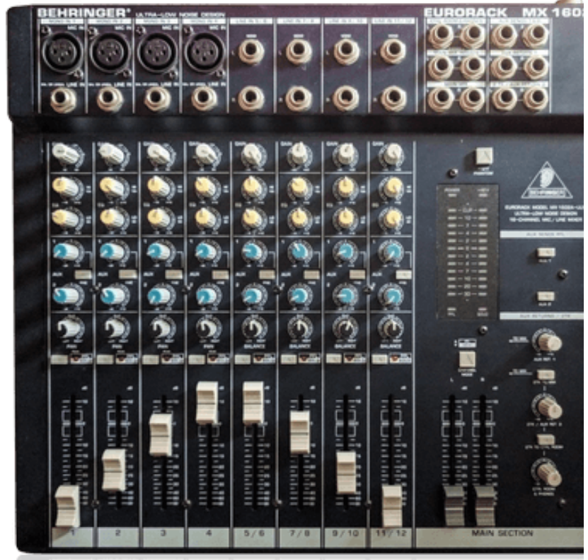

I am trying to figure out why the pair of LED meters do not track the main left and right outputs, as they would in every mixer I have ever encountered. From the block diagram, it appears that they should.
I am attaching images of the mixer as well, so you can see the physical controls (which is what I need to work with).
All of the controls, including the LED ladders, work if you set them in particular ways, so it's not a failed part, or at least it doesn't look that way.

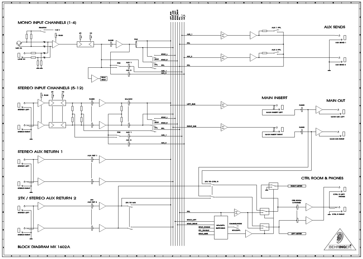

Here is where I lose my way in the block diagram:
Looking at the "CTRL ROOM AND PHONES" section (lower right),
The switch at the upper left corner of that section is labeled "2TK to CTRL R". It selects either the main post fader outputs or the "2TK/stereo aux ret 2" (lower left of block diagram).
Where is the corresponding physical switch in the controls ?
From there, the signal travels to a DPST switch, which selects either the main post fader outputs or the "PFL/Solo" signal.
Where is this corresponding physical switch ?
Another switch above the DPST connects the right meter.
Where is this switch ?

Which meter doesn't work?, is it the right one? - the block diagram, and schematic, clearly show a muting option on the right meter - with the left one always connected.
Presumably, it's for when you have Solo pressed, and it's only showing one input, so only needs a single mono meter.

2TK to CTRL R is the at the very bottom right, above the control room / phones output level pot. SW 22 A & B
(Control room - phones - monitor are all apparently the same output pair).
"DPST switch, which selects either the main post fader outputs or the "PFL/Solo" signal"
Button above the master output faders?
"Another switch above the DPST connects the right meter."
Same one, SW 20; it's a multi-pole switch - 20 B, the two above are 20 C and 20 D

RJenkinsGB, I stared at the block diagram after a few hours of sleep, and this what I see:
The "2TK TO MIX" button sends the "2TK/AUX RET 2" signal.
When open: nowhere.
When closed: to the main L/R buses.
This button switch is in the main control area, immediately below the "AUX RET 1" gain pot.
The "2TK TO CTRL R" button selects:
When open: the main post-fader outputs and send them toward the 3PDT switch.
When closed: the "2TK/AUX RET 2" signal and sends that toward the 3PDT switch.
The 3PDT switch selects:
When open: sends output of "2TK TO CTRL R" switch to both meters.
When closed: sends PFL/Solo signal to L meter, "CTRL R" and PHONES.
So with "2TK TO MIX" button up/open,
and "2TK TO CTRL R" button up/open,
and the 3PDT switch up/open,
the main L/R should hit both meters.
The button above the master faders is labeled "CHANNEL MODE", with "PFL(up)" and "Solo(down)" written above the button. That lets you choose either the PFL or Solo signals, and is not the 3PDT switch we are looking for.
So that mystery switch is the one I need to identify.

All the signal routing to the meters beyond the "2 TK TO MONITOR" switch is done by FETs acting as analog switches, controlled by logic signals.
SW20, PFL/Solo is used to select audio signals it the lower left of sheet 6, and another gang of SW20 is used at the right of that sheet to disable the right level meter, via a FET switch..
The logic signal that controls selection between normal stereo outputs and the PFL/Solo source is "SOLO_FET" which appears just right of centre in in that sheet.
I cannot so far find where that comes from. SW20 is actually a four pole, as 20B, 20C and 20D are on sheet six; 20A presumably exists somewhere?
Logically, if all the SOLO switches on the channel sections are off, and PFL is off, that should allow the main mix to the meters? Any channel SOLO switch on will cause re-routing.
Edit - found the FET switch control; if any of the channel SOLO switches are on, they ground a signal called ENABLE, which passed through an opamp comparator on sheet 7, and the output of that changes the meter mode and enables the LEDs connected to SW20A, which indicate PFL or SOLO.
If either LED is on, SOLO has been selected on a channel, which results in the meter mode change as I thought.
