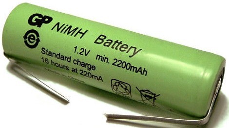

Hello folks, thanks for the replies and links. Most grateful.
I should have given more detail in my OP.
The battery is a single cell AA, with tabs/tags, recessed button, and sits on top of the main chipboard.
It's a tight fit in there with no room for two cells side-by-side. By the looks of things only a AA will suffice.
The pic almost exactly resembles the battery in my trimmer.
Having searched high and low, I view my problem is that they no longer sell single cell 2.4V batteries, they're 1.2V, moreover, the majority in the 600-800mAh range are AAA; nonetheless, from a couple of the links provided in the replies there is one 1.2V 600mAh AA available, and a 1.2V 550mAh AA available.
Would a 1.2V battery simply be half as powerful as a 2.4V and make the trimmers performance lame?
I watched a few videos online and these fellas carefully desoldered the tabs from the battery and then replaced it with a regular buttoned rechargeable battery and Bob's your uncle the trimmer worked just fine.

The mAh of a battery is not its power, it is how long a charge will power your device. Since the original battery had two cells in series then each cell is a little less than half the length of a new single AA cell. A new single AA Ni-MH battery cell has a capacity of about 2300mAh which is a little more (because modern cells are better than old cells) than double the original 750mAh.
A DC electric motor with half the voltage runs slower with less power. It might stall easily and might not start running.
It's a tight fit in there with no room for two cells side-by-side. [/QUOTE]
As everyone has said,it's NOT a single cell - it's two 1/2 AA cells in series to give the 2.4V - and two 1/2 AA cells in series looks like a single AA but has twice the voltage.
So you could make one with two of these in series:
https://uk.rs-online.com/web/p/speciality-size-rechargeable-batteries/0199652/
Please forgive my prolonged slow moment. I understand it now. 1/2 1.2v AA + 1/2 1.2v AA = What I need.
