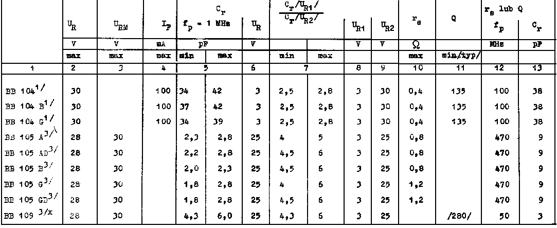

Maybe enough this?

Anyway i've found the original paper from TELEFUNKEN, and the data exactly same as CEMI (Poland, previous posted) device.
