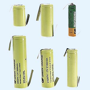

There are all kinds of single cells with a solder lug spot welded to the terminals.
Using that kind the batteries receive a small amount of heat when soldering them to a package.
Here is an image of the batteries.

I've found that batteries with solder lugs are more expensive so it might be cheaper to buy a battery holder.

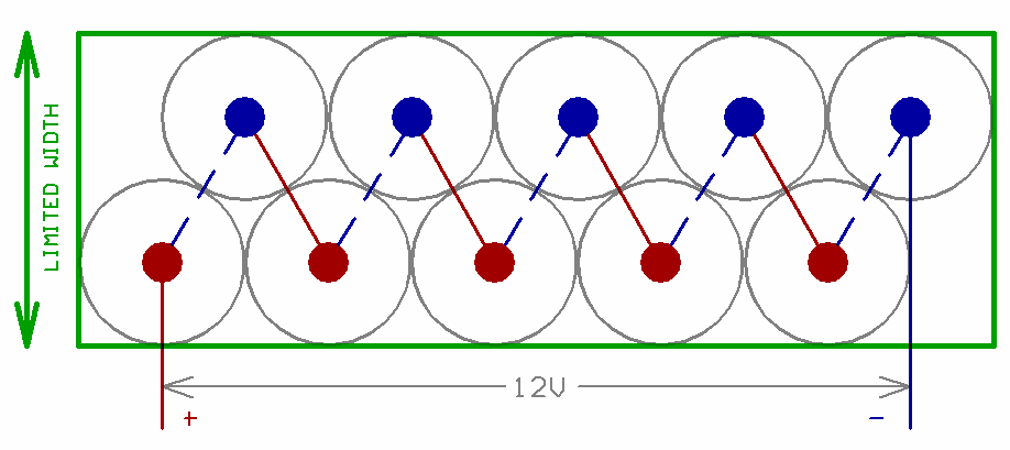

Can you beat that with a battery holder? :)

the pack is to be a double stick-nunchuk pack (only style that will fit within the space avaliable). I'm still not sure what kind of jig I'll use while assembling the linear sticks, but I'll find out soon enough.
