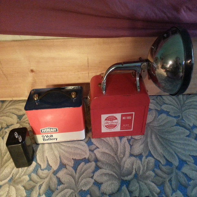

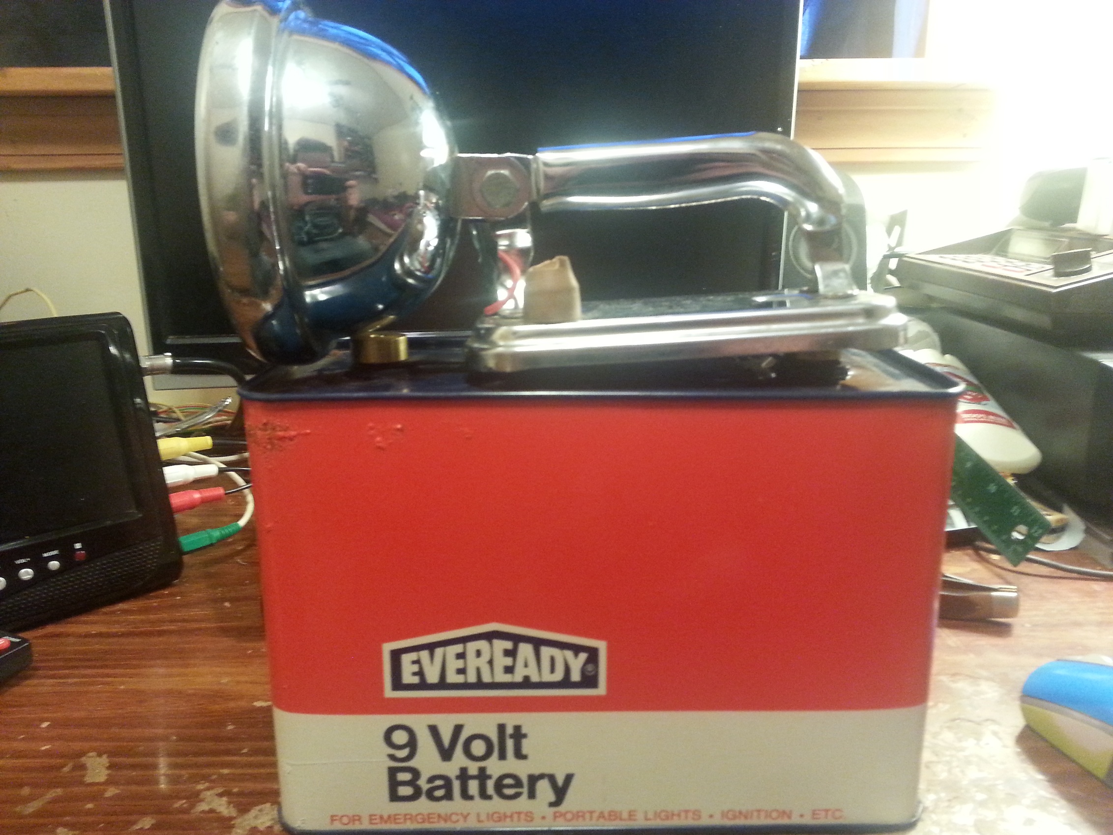

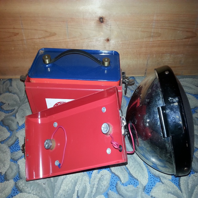

Anyways the reason im here as you can see from the tittle i posted i need help on making a sealed battery as the original is no longer being made and no alternatives are being made as well.
But befor i get into the battery making details i should tell you about the flashlight and the voltages i need.

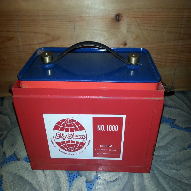

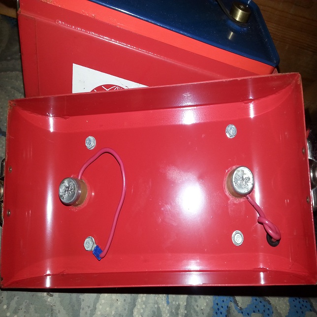

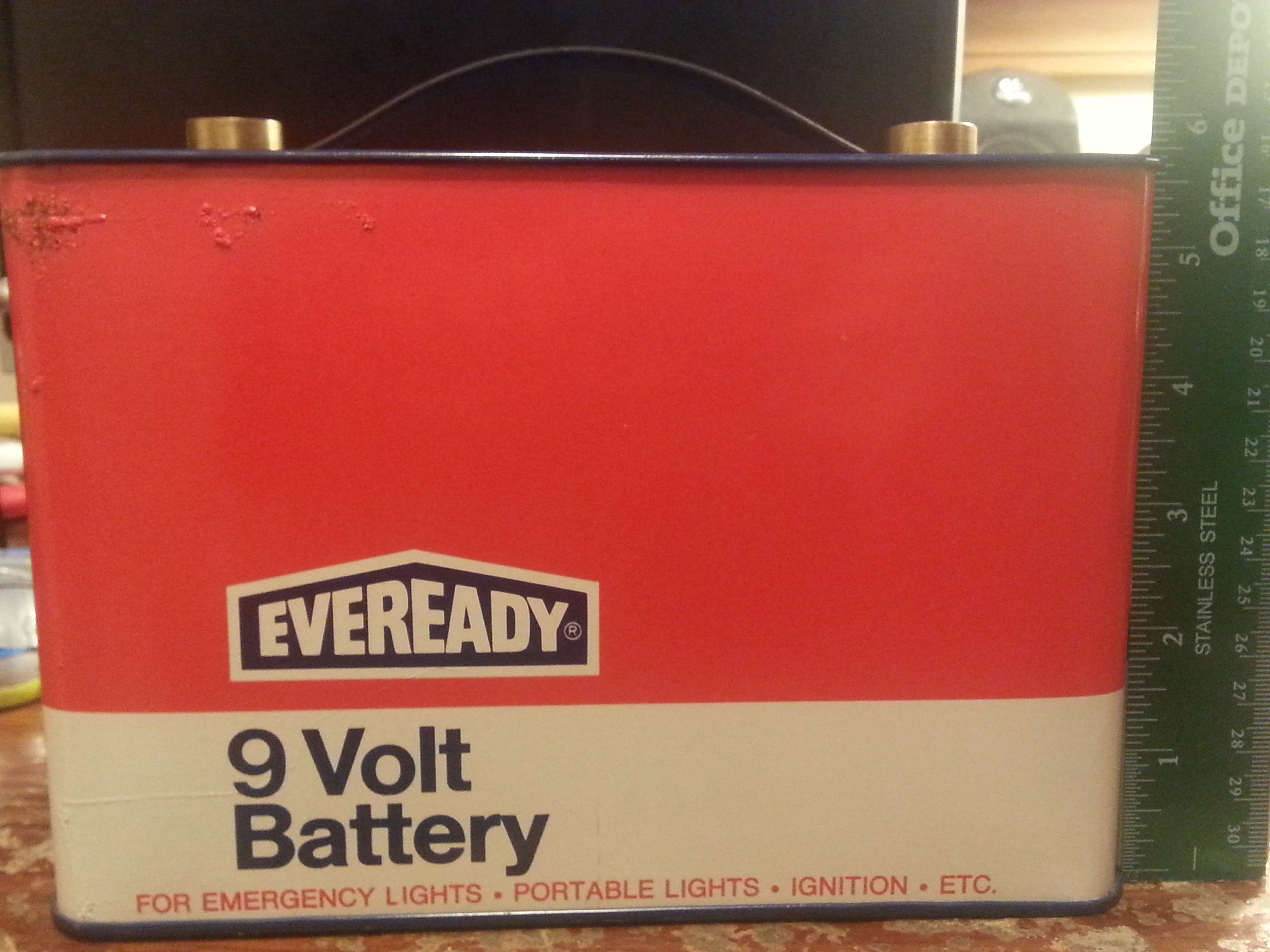

The Flashlight i have is a Teledyne Big Beam Model No.1000 which uses a huge 24 cell 9 volt screw terminal top battery which is bigger than a motorcycle battery, I need to make a new battery.
I have tested using a New Bright 9.6 volt RC car battery with success only problem is i find the voltage being a bit too much as i do not want to blow the original bulb the flashlight has.
Or better yet im playing it safe as the flashlight is older than i am and wish to step down or up the voltage to my liking since i do not know the highest voltage the bulbs can take i don't want to risk blowing them.
Ok ok enouth jubber jabber lolz the pictures i have will show the battery i need to make and the flashlight i will power with the new battery.

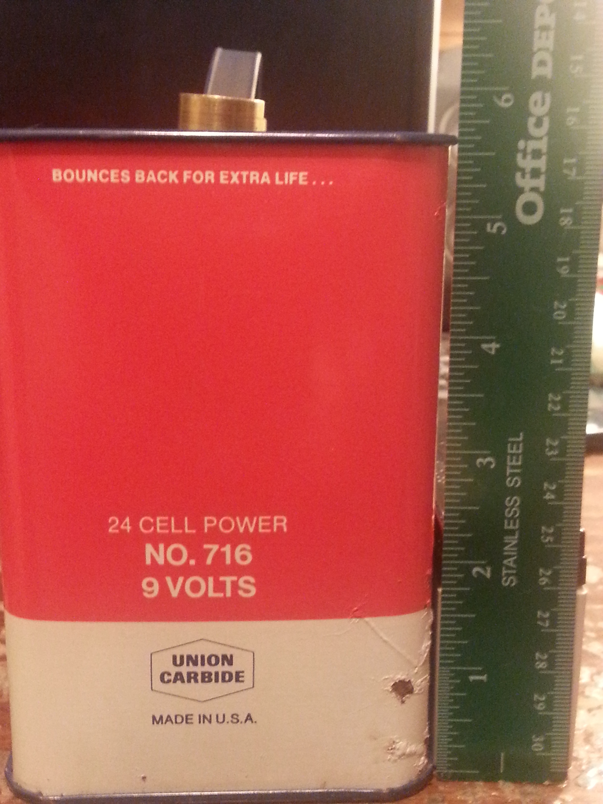

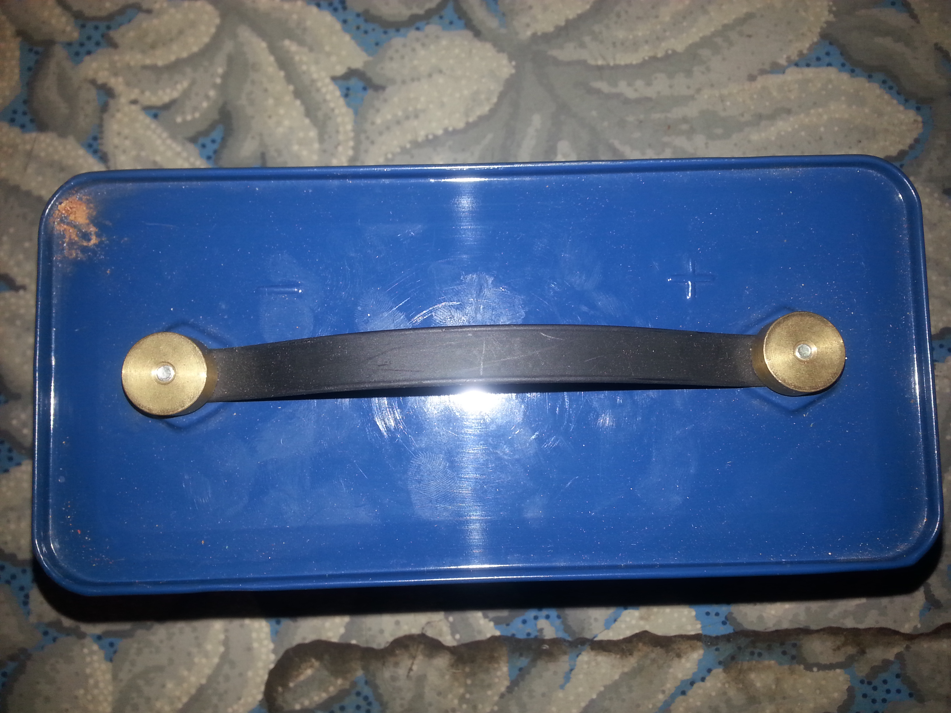

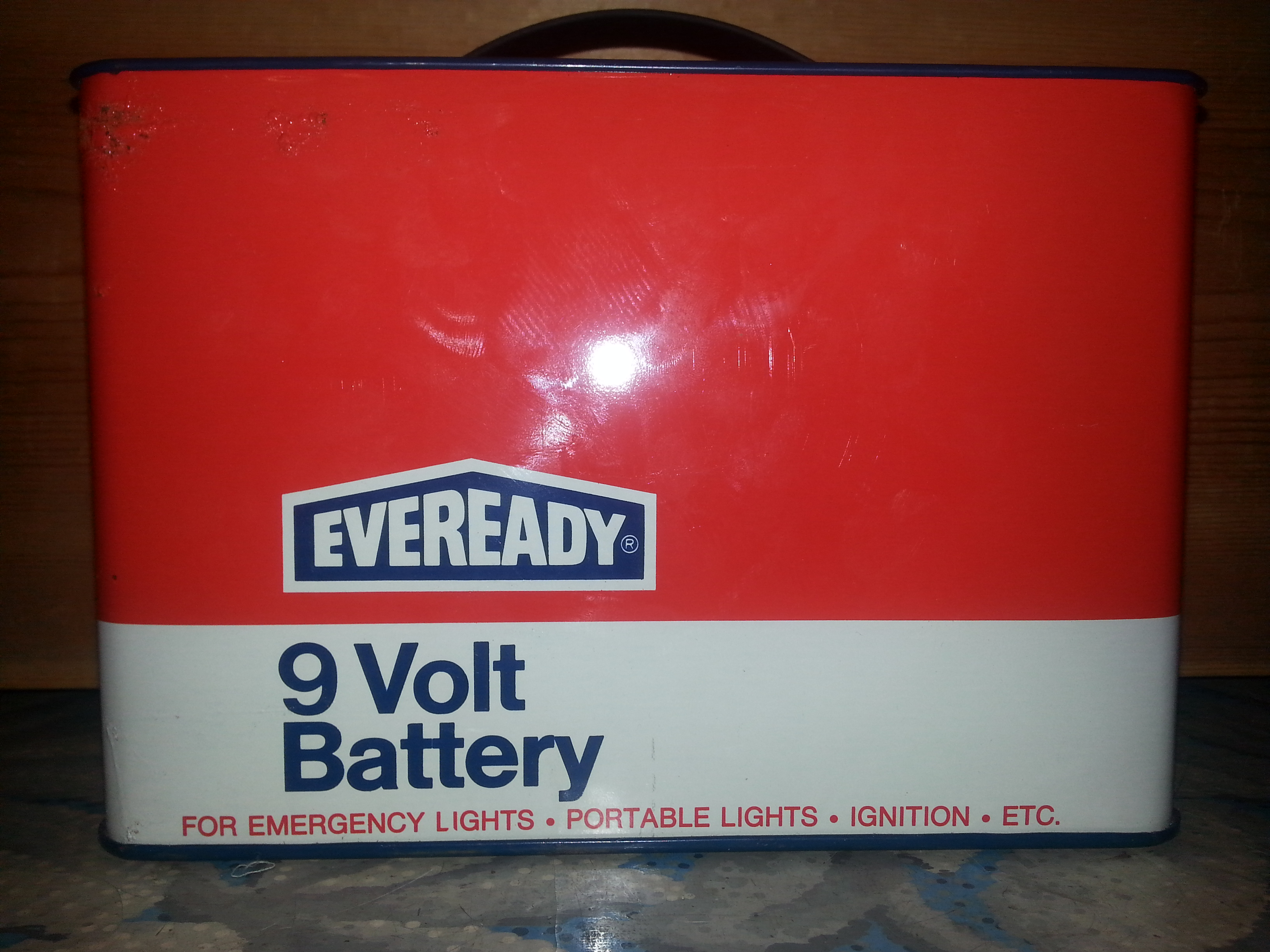

I presume the battery is made of TIN. can' you just pry open it and connect some ~1.6 volt cells in series? you can preserve the originality of the piece. Do I see a Union carbide writing? :sorry:

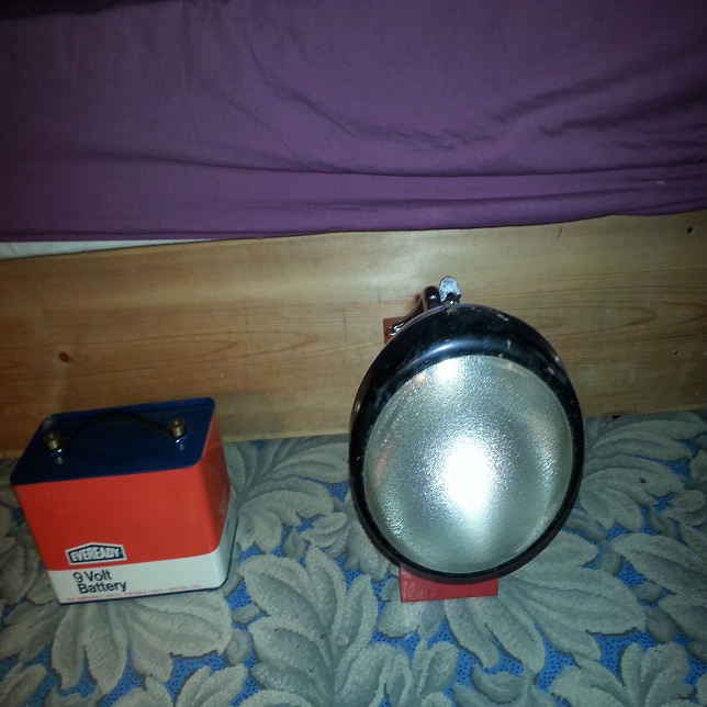

If you still want to get this old thing going, try to get at the bulb itself. It should be replaceable so you should be able to take it out and find the part number. If so, we can look up the part number and find out what kind of voltages it can take.

Well the whole idea is to preserve the battery as they are rare and cannot be found , so i need a plastic project box that is the same size with removeable lid.

The whole idea is to keep the flashlight as original as possible as the flashlight itself is hard to get and the socket for the bulb is much larger and unique as the ring on the bulb has a locking mechinism attached to it.
Looks like a replacement battery is available at ADFR & Associates. They have a #466 NEDA 904, 9V dry cell battery. It fits the Big Beam 1000
