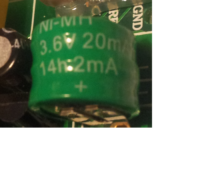

According to the battery label, it needs to charge for 14 hours (at 2mA) to reach full charge. But as others have said, after such a long time discharged it may be dead.

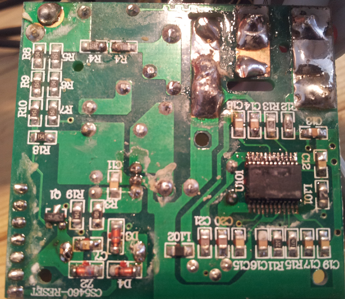

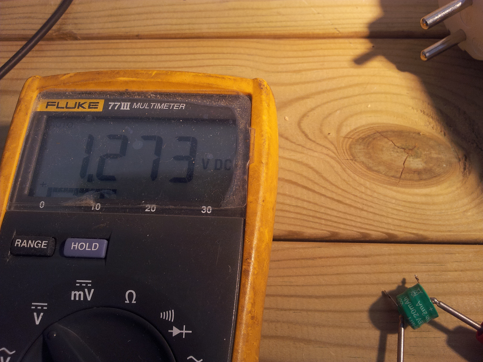

1. i pull out the battery from the PCB, and check the voltage : 1.27 Vdc

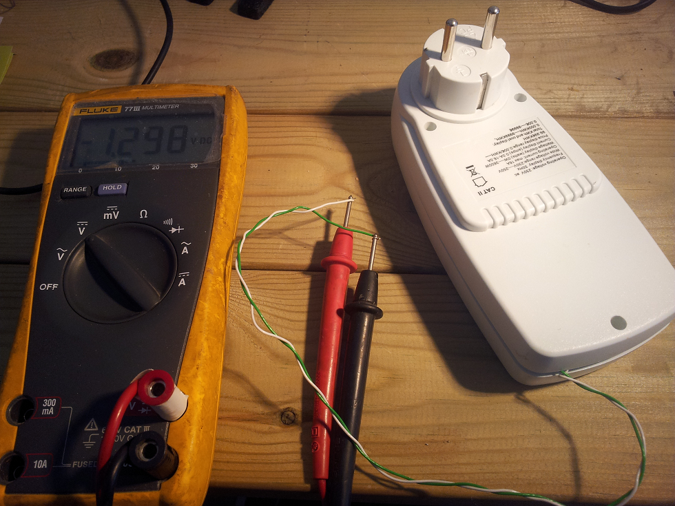

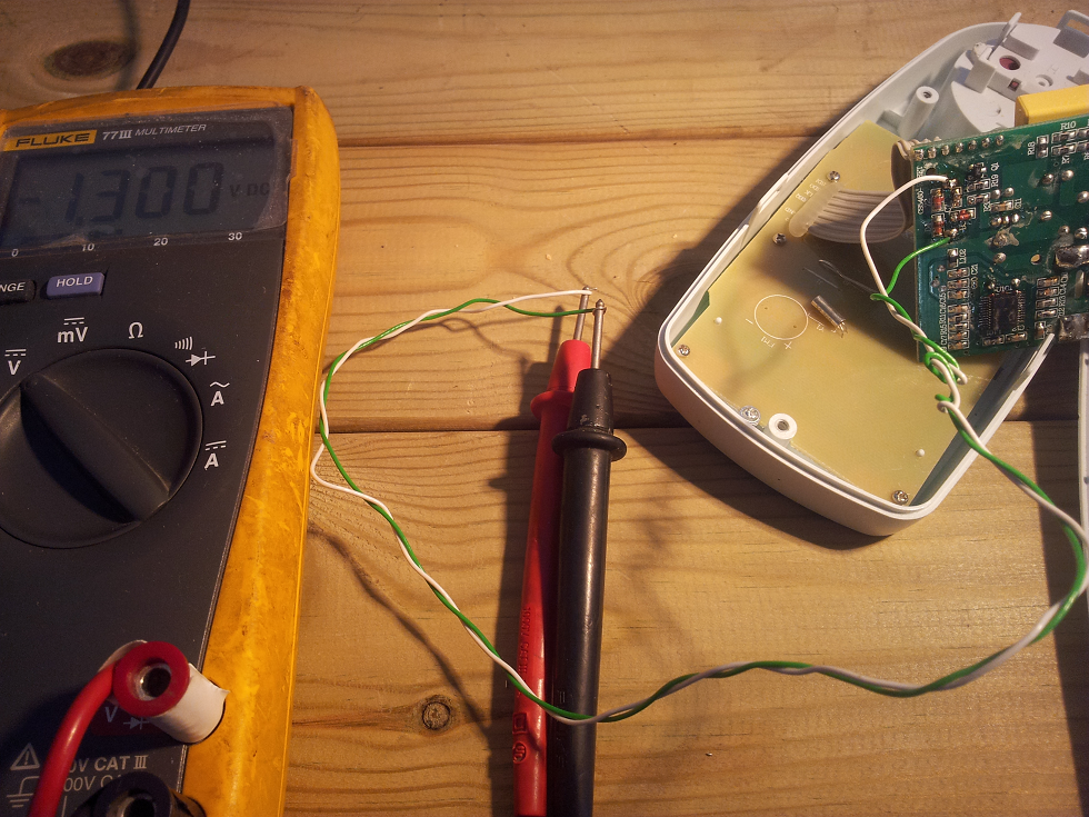

2. now get it back (soldering it back) and also soldered 2 wires from the battery outside the device, s i can measure its voltage when it is connected to 220VAC.
(you can see it in the photos attached)
3. the Volt Meter show that the voltage raise up till 1.6 Vdc and than stopped.
even after 3 hours - in 1.6Vdc the voltage stopped raising up.
(not sure if it have somthing with the bad soldering all over the PCB - this is how it cames)

The battery in your meter is labelled "3.6V" so since it charges to only 1.6V then either the battery is defective or the charger is defective. The battery should charge to about 4.2V.
The meter should be turned off for the battery to charge.
I also disconnected the multimeter from the battery (wires were disconnected from the multimeter for about 3 hours)
And still same results.
1.6vdc on the battery
The battery is made up of 3 cells. Two of the cells have gone short circuit. You MAY get it back to life by pulsing a fairly large current though it. You could use a 4.8 volt NiMh battery or a 6 volt lead acid battery . DO NOT CONNECT IT FOR MORE THAN ABOUT ONE SECOND. (It could explode if you do.) Even if this works it will probably fail again in a short time. The battery needs to be replaced. **broken link removed** that would probably fit.
