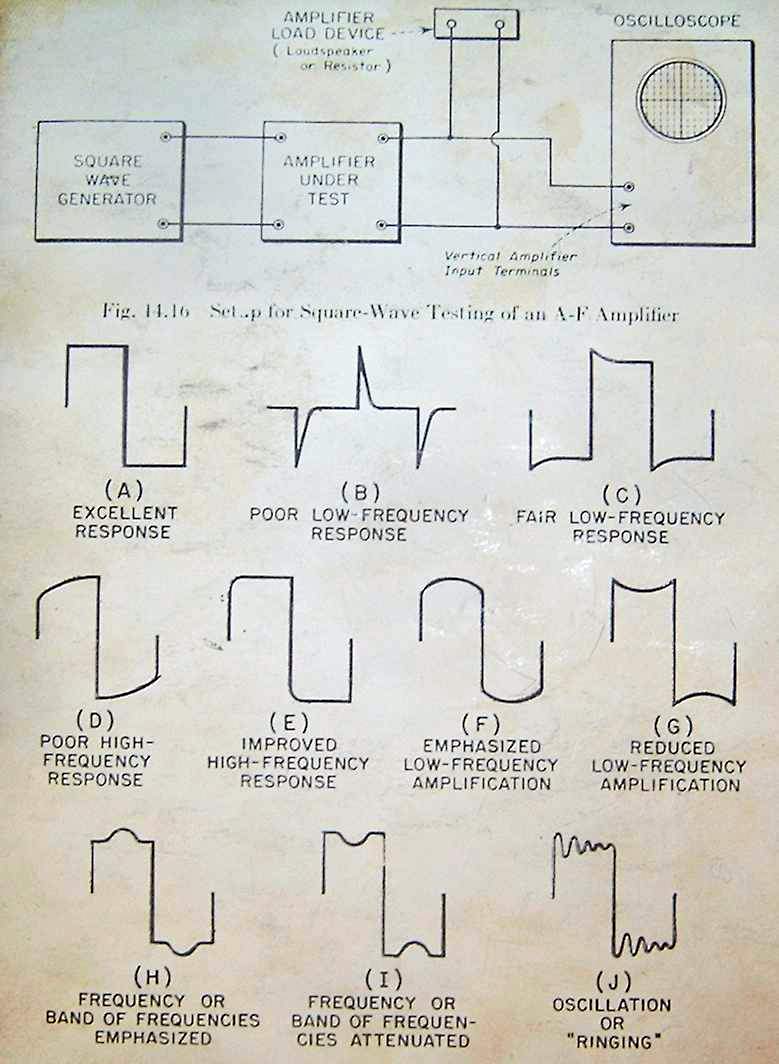

What are some basic Square wave distortion testing and checking
i can do ?
Are there any square wave distortion waveform charts?

If your'e using an oscilloscope to check square wave distortion (i don't know of any other way) make sure that your probe is correctly compensated. There should be a little jack that outputs a square wave from your oscilloscope, connect your probe to that. Then there is a little adjustable capacitor in the probe that you use to compensate it. If your probe is overcompensated, you will get sharp peaks, and if it is undercompensated, you will get rounded off edges. It should be in between . . . a SQUARE wave :lol:
If this procedure is not done, you will get incorrect measurements. This isn't only for squre waves, your scope should always be compensated correctly.
If i put a square wave in the input what does the square wave
look like if its distorted or with phase problems the waveshaping
should be different
Does this help?

A basic principle of trouble-shooting a cascade of stages is to start in the middle. That cuts the problem in half. Then check each component and stage until the faulty part is found. That may not be easy, especially if there is feedback. You will need to do DC measurments also, the problem could be a shorted capacitor or open resistor.

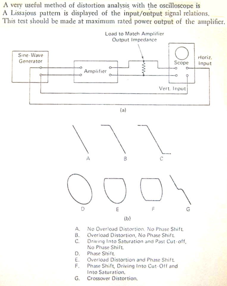

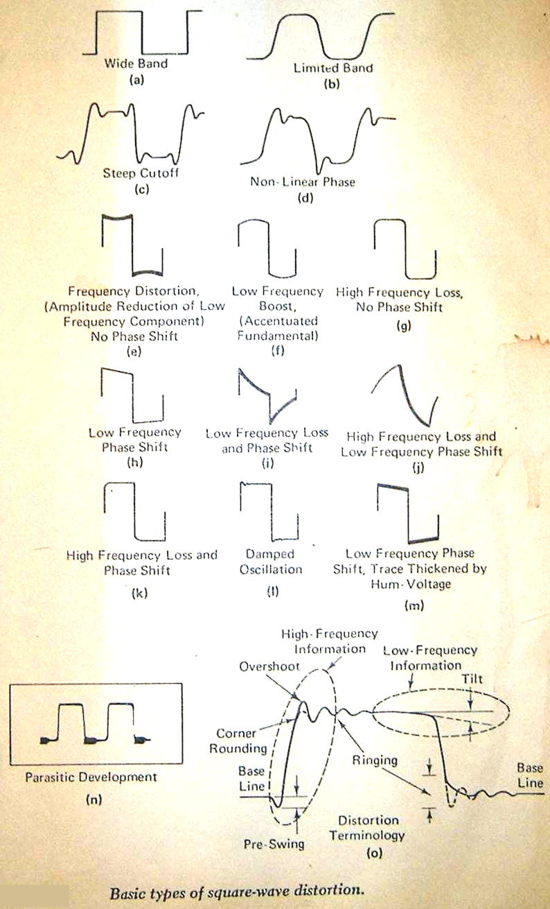

Sorry, I have No Idea.
These are Photographs, of Photostats, of Pages, of a few Books that I did back around 1970.
The names of the books are Not on these photostats.
I have a collection of these photostats, all on various topics. Great reference material.
Take care........Gary
