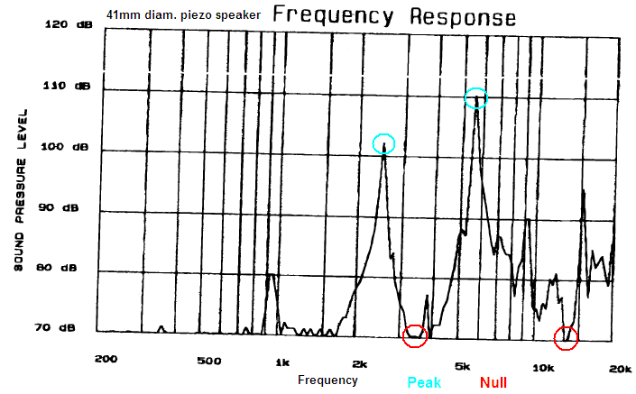

Have you looked at the frequency response of a piezo transducer? It plays many resonant peaks and nulls at high frequencies and almost no sounds below 2.5kHz. Here is an example:

A piezo beeper in a resonant plastic chamber with a little hole to let out the beep is different from a bare piezo transducer that I posted the horrible frequency response. The bare transducer is small and stiff so its resonances are at fairly high audio frequencies. It has no enclosure so the low frequency sounds from its rear comes around it and cancels the low frequency sounds from its front.
