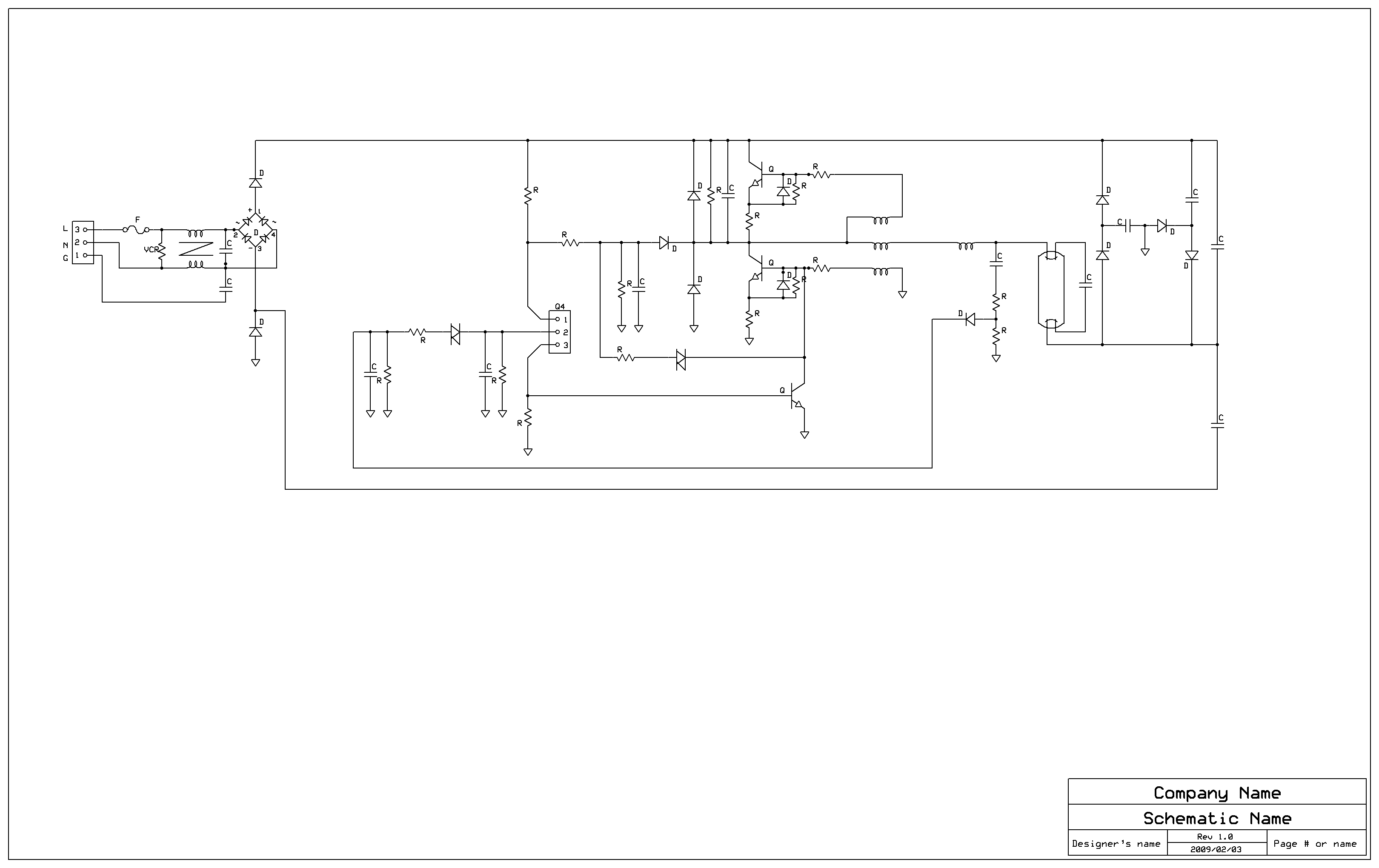

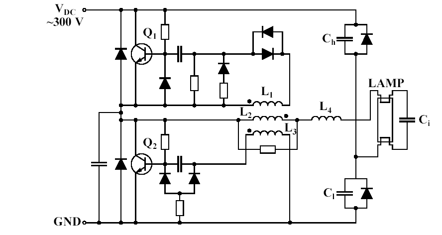

I want to find out how the attached ballast circuit is working. what exactly do the transistors do? what are the Cl and Ch used for and totally I need to know what exaclty every thing is doing.
I'm looking forward to your comments.

The wall outlet is a voltage source.
The tube wants to be driven by a current source.
The circuit converts one to the other.
One is the "dual" of the other.
To differentiate one from the other: I've never seen anything advertised as a power supply or voltage source with a source impedance higher than about 40Ω, so I imagine this circuit has a source impedance of several kΩ.
The transistors alternately switch one end of the fluro tube to the +Vdc rail & the GND rail & are the active part of the oscillator.
The other end of the tube is connected to the junction of 2 Capacitors Cl_Ch which is sortof half Vdc.
The capacitor/inductor values & oscillation frequency are chosen to provide sinusoidal (AC)current to the tube.
This is not an "exactly" explanation but just general.
Have a look at International Rectifier application notes, there are lots of good info on fluro lamp driving.

Back to the original circuit (& question):...
The nom. 300Vdc would be from bridge rectified mains(220V) & a filter cap.
Ci bleeds off a bit of the main tube current to heat the filaments, much less filament current once the tube has ionised.
L1,L2,L3 is a base drive transformer for the transistors with L1 & L3 windings 180 deg. phase so each transistor turns on alternately.
L4 smooths the tube current waveform edges (& the C1 & Ch capacitors smooth the top of the current waveform).
The capacitor to GND from the power switching node(Q1-E) supresses transistor turn off oscillations (visible in simulation) & smooths tube current waveform.
The circuit will start by the top transistors turning on (via bleed resistor) & producing current thru L2 winding & this in turn produces base voltage in both L1/L3 windings, turning off Q1 & turning on Q2 & now it will oscillate.
There is very little symmetry in the design of the 2 base drive circuits, this would likely be a result of design testing to optimise the performance.

Your comments are very helpful. could you tell me what are the 2 diodes parallel to the transistores used for?

Fahime, the 2 diodes across the power transistors are for protection. They clamp voltage of the power switching node to the power rails.

Please take a look at the attached schematic. I have this ballast in hand with some blown components. I figured out what the blown components are but the Q4. Can you guess what it is?
I guess it's a SCR. Am I right?
Fahime please post a clear photo of the board.
What are the markings on the device Q4
Did youi draw out this schematic or is it supplied with the hardware.
How did the parts blow, in use, lightning, testing ???
hey,
I can't read the marking. it's not clear. It burned in use. I just replaced it with a MCR100 and it works. So it is a SCR for sure.
