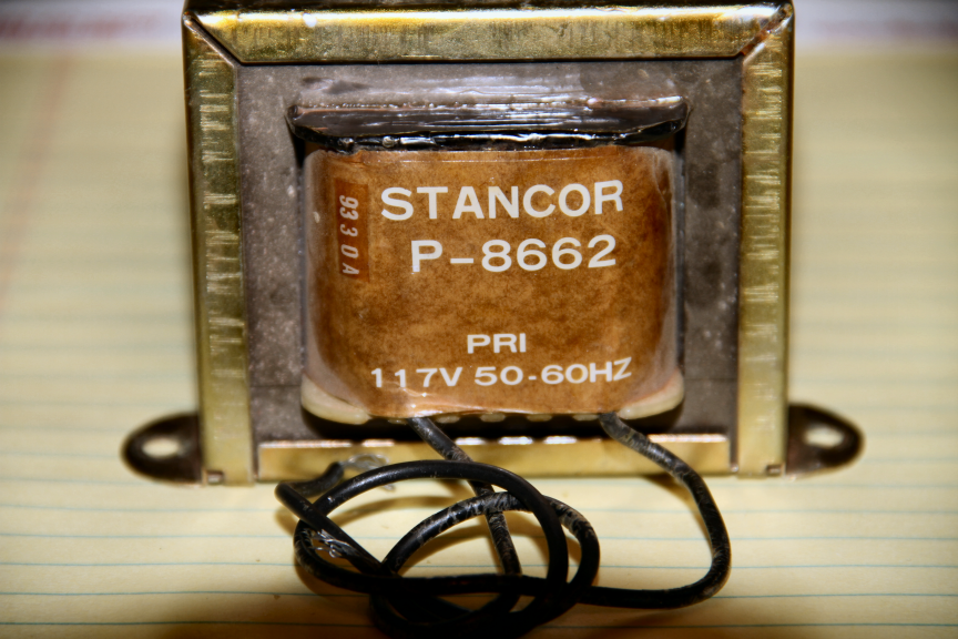

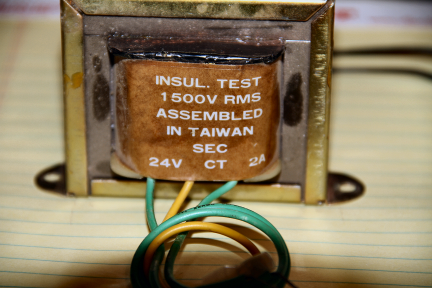

Back to transformers below are a few images of the transformer I mentioned earlier. Note the primary in this case is Black and the 24 VAC CT (Center Tapped) happen to be green with a Yellow CT.
Transformer Primary
Transformer Secondary

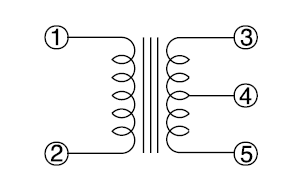

Schematic Representation
Pins 1&2 are the Primary (Black) and pins 3&5 are the Secondary (Green) with pin 4 (Yellow) being the CT of the secondary.
