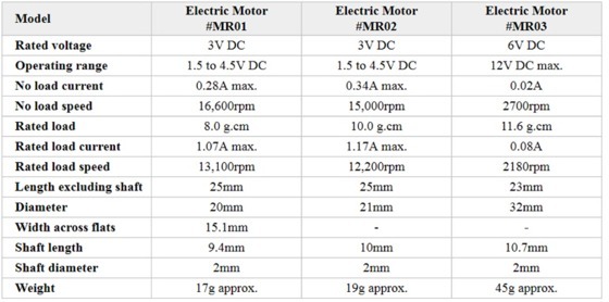

I've a question about amperage output:
(click on the image to enlarge)
#Mr03 model
If I rotate it at 2700 rpm, what would be the amperage? 0.08?

Yes it would b .08 amps with a realistic output of about 80% of its rated voltage as a motor or pretty close to 5 volts.
When using a PM motor as a generator what ever was its rated input amps as a motor will now be your maximum continuous rated output amps as a generator.
Also when loaded to that amp limit working as a generator at the same input RPMs the output voltage will be around 80% of its motor rating on average but that can vary some depending on the design. Some may putout over 90% of their ratted voltage while others can be less than 50%.
eBay is also where I get all of my motors I use to make generators for my wind and AE experiments and the 80% output voltage ratio has always been a pretty consistent expected approximation for the good quality units I buy:D
(Granted the ones I use tend to be rated for ~40 - 80 amps at 50 volts or higher working as generators.):p
