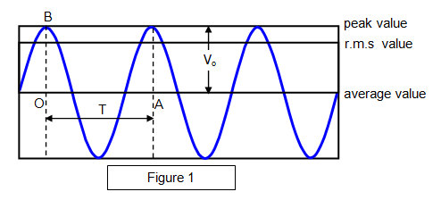

If you have a load that draws 10 watts for 50 percent of the time that means its instantaneous power is 10 watts during the time it is on, but because it's only on for 50 percent of the time the average power is only 5 watts.
The average power is the true power delivered to a load over a period of time.
If we knew the peak voltage of a sine wave we could get the RMS value by dividing by the square root of 2. If we knew the peak current of a sine wave we could get the RMS value also by dividing by the square root of 2. Thus we might say that if we knew the peak power we could divide by the square root of 2 to get the RMS power but it's not really right. If we knew the peak power that would mean that we knew the peak voltage and peak amps and multiplying the two we would get the peak power, so to get anything useful we'd have to divide the peak power by the square root of 2 twice, which would mean we would be dividing the peak power by 2.
Lets see, if we had 100 volts rms and 5 amps rms that would be 500va, in phase that would be 500watts and that would also be the average power and that's all we would have to know. We dont need anything called Watts RMS, so they must have made that up to avoid working with any phase angle and didnt want to call it VA (Volt Amps) because it would not make as much sense to audiophiles.
So the only time "Watts RMS" *should* be different than "Watts Average" is when the phase angle is not zero degrees, but in audio i dont think the phase angle is usually a consideration when specifying power.
So there is some justification in defining this new quantity although it's not a true measurement in every sense.
There's another problem that could come up however. That's when the peak power is defined as the maximum power the amp can put out for a short period of time but not sustain that output power forever. Trying to figure out the average power from this kind of specification would not work at all because we'd only know what it can do for a short time period and not for the entire operation time. I'd be very surprised if they defined "Watts RMS" from this starting point, but then again i tend to not believe anything the audio world specifies these days.
I think the term first came into use when they started measuring the output power by measuring the rms voltage and then calculating the power into a given load resistance. Thus the "RMS Watts" would be the same as the average power which is the same as the effective power which is the same as the continuous power.
For an ac voltage source delivered to a resistive load, the RMS value is also called the effective (average) value which is the equivelent value that is delivered by DC. RMS stands for Root Mean Value, mathematically the RMS value for points m = r1, r2, r3, ... rn is
RMSm = sqrt( (r1^2 + r2^2 + r3^2...rn^2) / n ) where n is the number of points taken.
Electrically, Pave = Irms * Vrms = (Im * Vm / 2) where Im and Vm are peak values.
