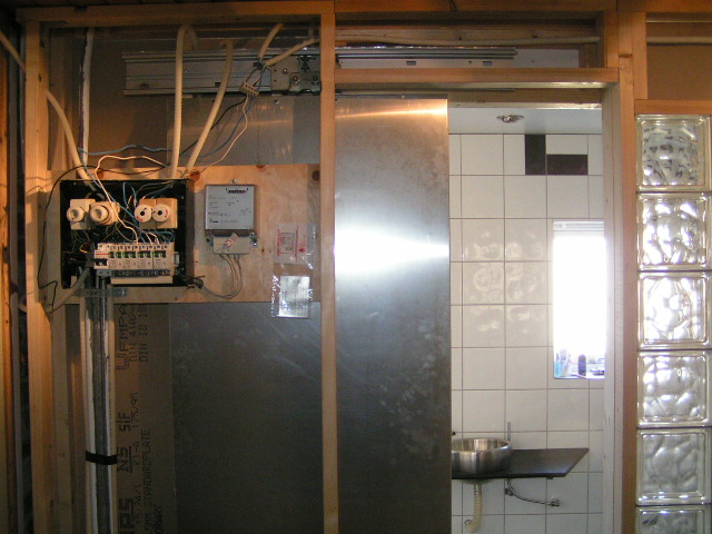

I have made a new bathroom door in 5mm aluminium and it slides very easy with ballbearings. Since I am a scifi fan I was thinking of making some sort of automatic open and closing of the door.
Requirements:
- open/close from both inside and outside
- be able to lock it from the inside
- a function that shuts the mechanism off if something/someone is
blocking the door
What I think would be cool:
since the door is aluminium, would it be possible to make the open switch to be the door itself, like those touch switches used in some different lightswitches?
So one little touch to the door and it opens and perhaps have a automatic close function, delay of about 5 sec. and then have a switch inside that turns of the power to the circuit, then the door would be locked.
I will try and attach some picture of the door.
(no comments on the wiring :p )

well the shower is isolated in a corner and has a fan above that starts when showering so the door never gets wet, and I was thinking of having a switch inside that turned of the power to the door so it would be locked.
