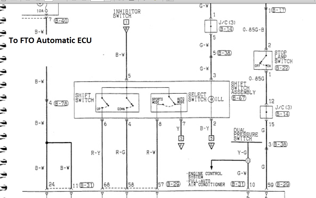

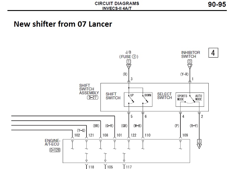

Hello,
I have a Mitsubishi Mirage with a Mivec V6 in it out of a FTO, I got the car with no tiptronic shifter so purchased on from a local wreckers after purchasing I found the plugs were different. I am just wondering if there is a way to wire it up so it talks to the tiptronic ECU.
I have attached both wiring diagrams of the switch. Please let me know if more information is needed.
Thank you in advance to any help provided.
Regards,
A

Confused. Your pic has the word "Lancer" in the filename. Your post doesn't.
So, fill in the blanks:
I have an automobile that uses the wiring diagram (filename #1) , but I accidentally bought a shifter switch that has this (filename #2) wiring diagram). Can I make it work?

It seems like your OK except that the new switch does not contain the light, otherwise the swap looks straightforward.
You might post some more of the Illuminatiion circuit and look at your car's instructions to see if the LAMP is driven from the ECU and provides other functions by blinking etc. or is it strictly dash lighting.
