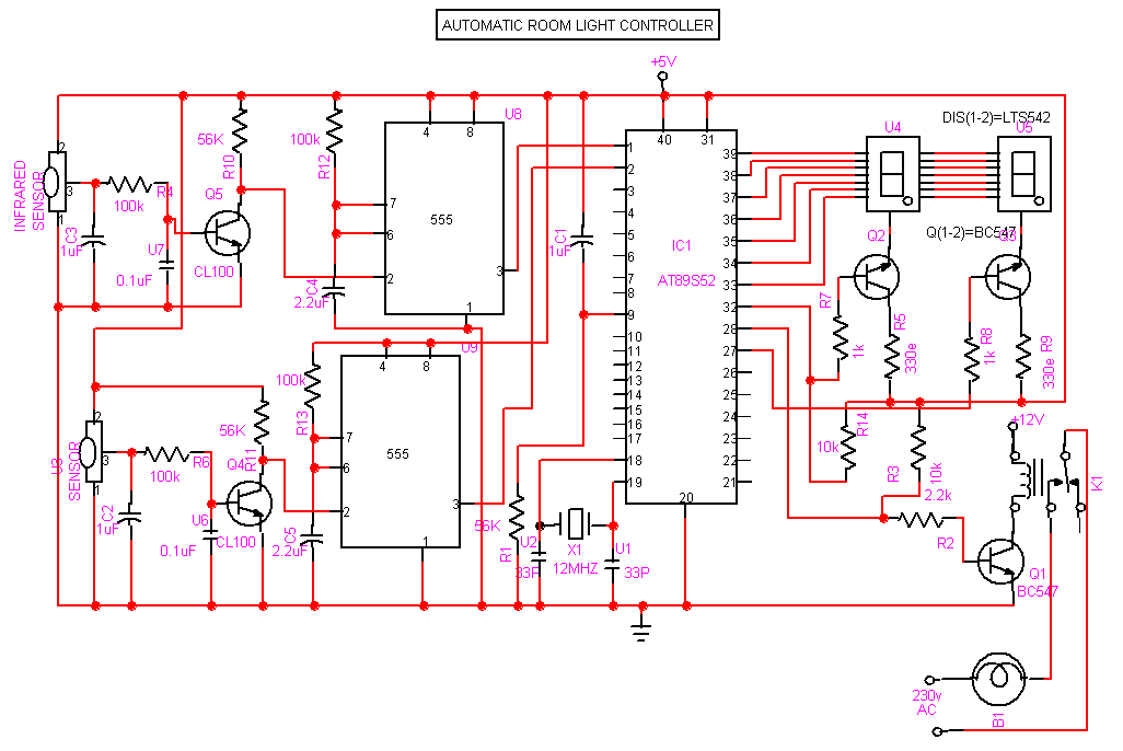

I need a help here. I am doing automatic room light controller as my fyp.
The circuit i got is using microcontroller and i plan to change it to PIC.
Can i change to PIC without modify the original circuit?
Another thing is i plan to change the two 7segments to a LCD.
Which part i should remove?
below is the circuit diagram

The program will have to be rewritten to suit a PIC.
The LED circuitry will have to be replaced using an LCD [ the re-written programme will require the LCD driver routines]
The IR detection circuit and the relay drive could be the same, make sure that the input pins match the PIC pins and program also the AT to PIC pin numbers/assignments need changing.
You are basically starting from the beginning, you could still use the AT algorithms but their coding will have to be changed to suit the PIC.

u said "The IR detection circuit and the relay drive could be the same, make sure that the input pins match the PIC pins " mean that there are specific pin for them?
cannot connect to any open port?
As for the LCD, can i remove pin27,32-37 and replace it to LCD?
And for the pin28 which is the connection for relay. Can i use back the same circuit?

You could any suitable port pin, providing that the re written program uses that port.
The AT pin assignment numbers may not match the PIC pin numbers.
That again depends upon how you assign the PIC I/O pins in the PIC program
A PIC output pin could drive the transistor.

I would suggest that you draw out the circuit showing which PIC type and pin usage you plan to use, its difficult to comment until we know what you have in mind.
Which PIC programming language will you be using.?
An LED display and an LCD display are two completely different technologiew. Your final design will have to accommodate those differences. That means both in hardware and software (firmware). COMPLETELY DIFFERENT.
An LCD character display does not use the same circuitry as an LED display, so you will have to start from scratch with the display. You should first identify the LCD display that you want to use and then design the circuitry around its requirements. Without knowing the display's requirements, no one can say how to connect it to a PIC or microcontroller.

A couple of observations.
You could probably skip the 555 part and use the pair of comparators built into the 16F877A
Upgrade to a 16F887 and you can also skip the crystal.
Your relay driver looks fine, just be really careful when dealing with mains power.
I wouldn't be so quick to approve of the relay circuit.. While the circuit diagram itself looks OK, the transistor driving the LED and relay is a wimp, being rated at only 100ma. Best to use a transistor having (much) higher collector current rating, something around 1A or so. Just be sure that it has ample capability to drive both the relay coil and the LED.

why get so complex?
if all you want to do is turn on a light using an IR sensor then just buy a IOR sensor light relay. no need for an LCD display (have yet to figure out why the display?)
I must have missed something??
a simple IR sensor is available from SURE ELECTRONICS. DC-SS015
I use thyis module in my CRITTER RIDDER for scaring away deer from ones garrden.
Very easy to include an LCD display but suggest using say an 18F1320
as for relay control, watch your relay coil draw and inmclude a diode to control coil flux but an FET would be my choice for switching dc.
I looked at you schematic. the LCD only needs 6 connections plus Vcc and Vdd
why the 55? not needed
another curious question ? why the two 555's
why the max232?
would help if you could explain in complerte detail what your end tresult is supposed to be???
also your schematic does not show, althought not required in finished project but makes life easier, is an ICSP header
here this should get you started
you can eliminate the 555's. may cause false triggering as the 555 is not a stable output frequency.
using the IR circuits in this link will limprove the circuit as well as simplify. go with the KISS method. will save lots of debuging headachs.
