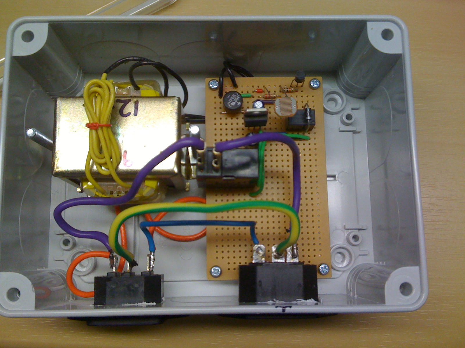

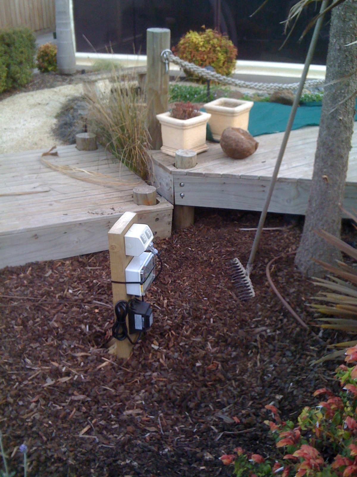

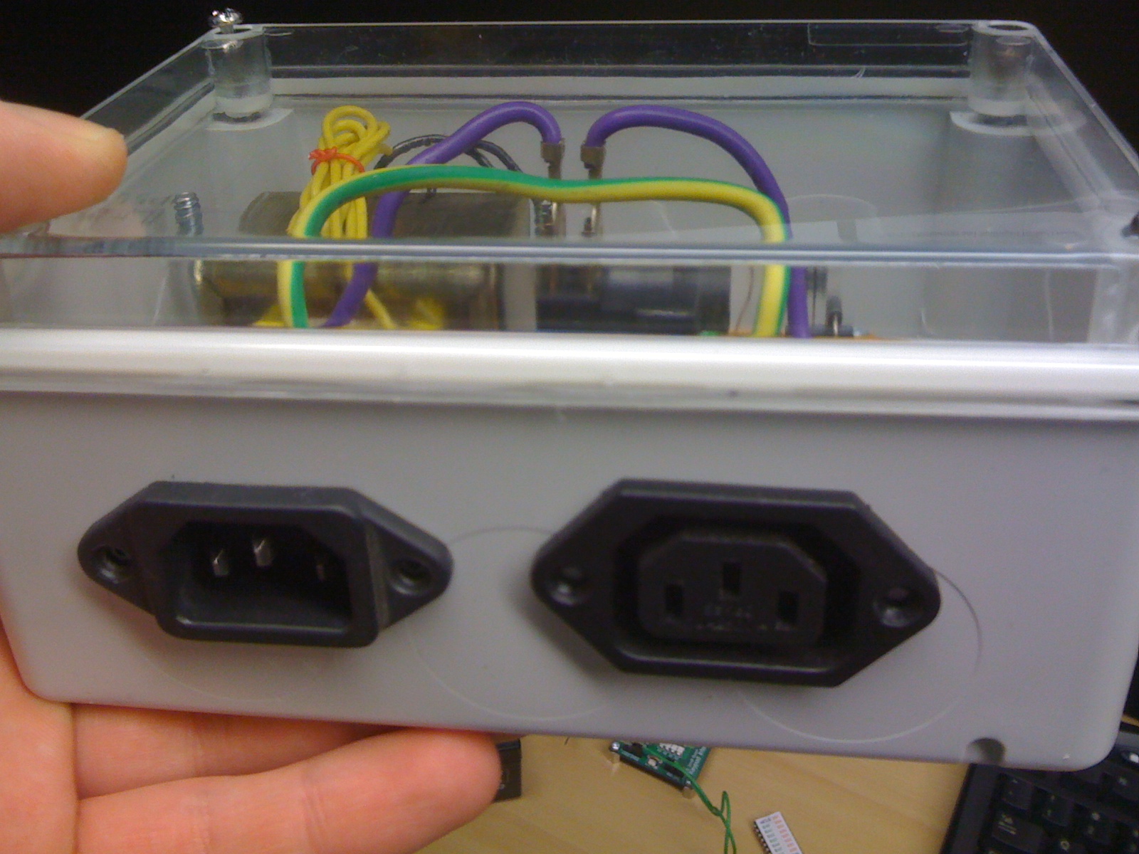

I just built one.
cost me 7 bucks.
Found everything execpt the enclosure in the shed.
even used IEC connections off an old computer power supply, and a 8A 250VAC spade lug relay out of an old microwave.
Im hoping to change it over to A/D rather than transistor threshold type of thing.
Here's a pic or 3:

That's awesome! There's one big reason to build your own, even when commercial units are available... Nerdvana!

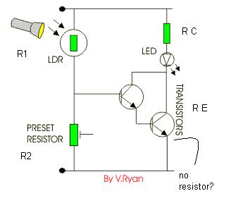

i have some doubts in the design?
Where should i put the R1,R2,RE,RC?
R1> ???
R2> in series with presettable resistor?
RE > in series with LED and another;
RC > not there in the circuit-diagram? Why Cant i use it?
Shouldn't i use actual resistors and then use additional presetable resistors?
Answer Please I'm Still Learning

First, be aware that the circuit you show after Ryan, is a light detector. It will react in the presence of light and its LED will then glow. However; it is a simple matter to change. Merely swap the locations of the LDR and preset resistor.
Now, to your questions:
R1 is the LDR
R2 is the preset resistor, a potentiometer. If you don't have one, measure the resistance across the LDR when dark, and try to find a resistor close to that reading. That will give you an equal voltage divider, and a good start.
RC is the current limiting resistor that goes with every LED
You don't need an RE because this is a switching circuit, not an amplifier or emitter follower.
The two transistors form a Darlington pair - more bang for the buck, but not really necessary. One small signal NPN will do.
Make the changes I have recommended, build the circuit as closely as you can, and you will have a circuit that will turn on a LED when the ambiant light (roomlight) is dark enough. It will not turn on your tube light... that requires much more circuitry. But it is part of the learning process.
i did the circuit, using transistor SL-100;
i couldn't make the LED glow at the required darkness,
the light keeps glowing till a bright light is subjected to it.
Is it because the LDR i'm using? Should i use a different one?
i'm using a 10K Potentiomenter for the circuit?
Why is it not working? What changes should i make?

Not being able to see your circuit makes troubleshooting difficult.
I think all we have is a matter of calibration. Adjust the pot through its range and you should find a point where the LED will go off in rather dim light. Using that point as our trigger point, we should find that any darker conditions will cause the LED to glow, but stay off if more light is applied.
If adjusting the pot through its range has no noticable effect, swap the positions of the LDR and pot and try again.

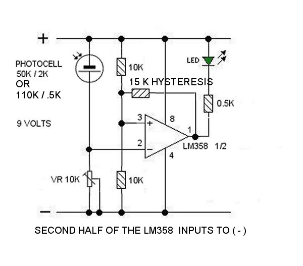

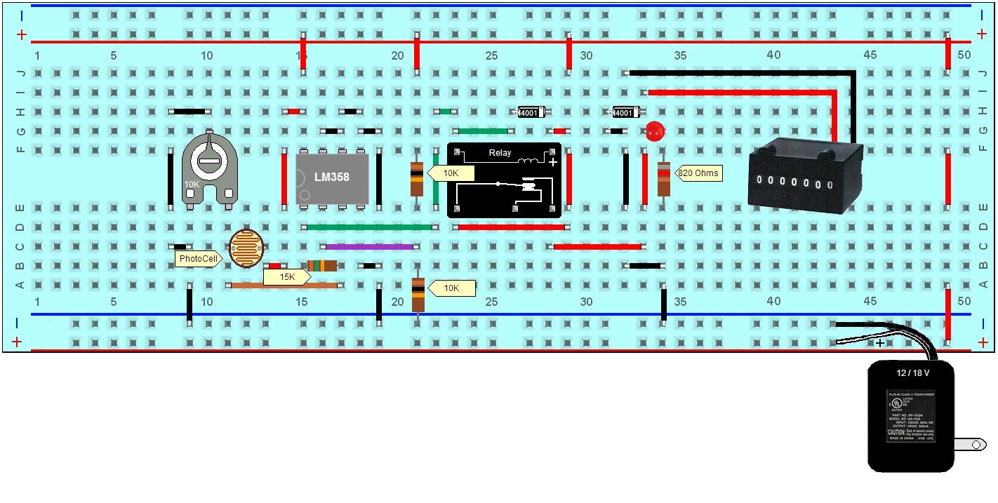

This design found in the web is working very nicely:
The breadboard circuit is for counting something that is breaking the light beam to the photocell but the principle is the same. The 10K VR will fine tune the intensity of the light needed to trigger the relay.
Alain
