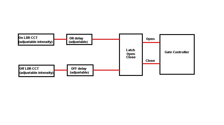

you can use two LDR circuits for different intensities and delay adjustments as shown in the pic. some one can post the diagram?

Maybe this is what your looking for ?
Here seems to be a good one and you can build 2 of these boards one for open and one for closed.
I would add 2 lever action switches both are ( N.C.)
1.When light activates the first board starts the motor bringing the travel of the door all the way up to the top switch which will open it contacts stopping the motor.
2. The second board sensing dark brings the door down until the door reaches bottom which opens bottom switch contacts allowing for the start of the morning session.
Reverse polarity ( +- / -+) for the opposite direction of motor.

also one pint to be noted, both signals should not overlap, ie should not appear at the same time.(open & close, open command should go off before close command comes in action and vise versa)
when a latching circuit is used it can be set and reset by pulses only. the last received pulse will be latched and no fear of overlapping.
OR the limit switches that are used for motor can be wired in such a way to enable either open or close circuit only one at a time.
