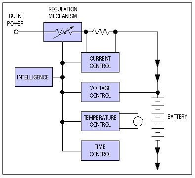

I'm not sure whether all type of battery can be charge within the same battery charger since different battery have different characteristic. There is float and boost circuit that can control the maximum current and voltage of the battery but I not sure how to do it and there circuit look liked? The boost circuit can increase the current in a certain time (temperature will rise if the batteries reach at maximum level). I plan to use the same type of battery but different voltage (6V, 12 and 24V)
If anyone can share the schematic and diagrams? And where can I find any information and circuit, it is better to understand.

In order to sense what voltage the battery is you will need to use 3 ADC pins each with a resistive divider to drop the voltage to suit the ADC pin. Now assuming the maximum charge is 5 amps once you know what voltage battery is in the voltage for each battery will have a float value which the voltage will be monitored by the ADC pin that is the battery voltage.
It's upto you to research the spec's for each battery voltage and make a start on the pic program and schematic.
