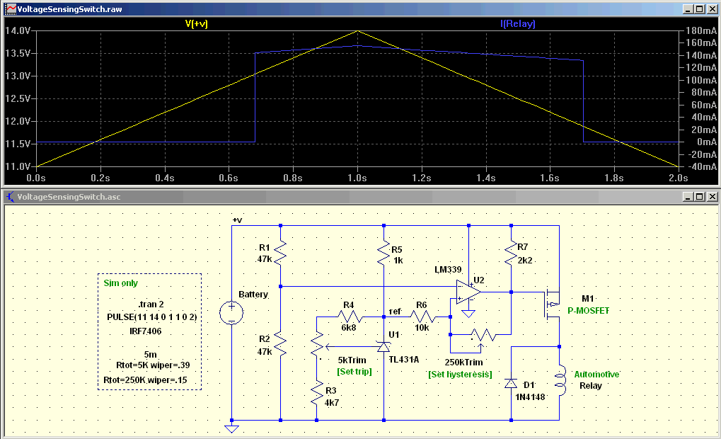

If I've understood your requirements correctly, this should do the trick :-
No that does not do Stage 1 or stage 3
It is just CV hysteresis, which is none of the steps I outlined.
Step 1 requires current sense or a supply incapable of exceeding the charge rate.
Step 3 Float requires Current sense to be below 10% of rated current so that voltage is latched to the float voltage until a load drops the voltage below a specified amount the restart into Step 2~ 3 mode, which may oscillate over a long period, which is ok, not a short period.
This simplest design is a current limited CV set to float voltage.
Perhaps the OP should clarify.

Yes. The circuit I posted would enable either option if, say, a SPDT relay were used. Perhaps the motor is for a fan which cools a battery charger? Who knows .
I can't understand how it works and looks great but for me to build this circuit I'll need explanations on how to connect the microchips, as I've seen they have many inputs-outputs. Also which would be the relay specs? Do you think the motor or the circuit needs a fuse? what max current should it stand?
