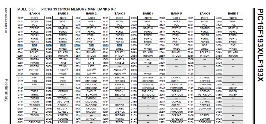

Not sure if Banksel works with new PICs which have the banksel register!
Somebody please confirm / deny :D
Banksel isn't a register. It's an assembler directive which MPASM works with to switch banks.
Here ya go

BANKSEL still works like a charm on the enhanced midranges.
I'm assuming where the assembler would change BANKSEL to a status bit manipulation command on the regular midranges it's just using a MOVLB now. BANKSEL helps a lot because I don't have to actually know which bank the register is in, but you still have to refer to a sheet or else you will be "BANKSEL"ing everything and IMO bloating your code.

Wow...I wasn't aware of these new 16F series pics! Looks like they've got more resources than I could ever hope to use. That 16F1933 looks like it could give an 8031/8051 a run for its money.
In any event I just wrote a test code for the 16F1933 using banksel. Then I assembled it, then disassembled it. It looks like banksel does indeed do what it does for the other 16F series PICs, however instead of it inserting code that sets/clears STATUS RP0/RP1 register bits, banksel directs the assembler to do a MOVLB instruction based on which bank the register you're banksel'ing to resides in.
