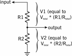

How 'bout a simple potentiometer before the amp? That way you can adjust the level for optimum quality. A 50K audio-taper pot (stereo) ought to do the trick.
This way you have a constant impedance on the input side (whatever the value of the pot is).
Ackshooly, on further thought, you probably don't want a big old pot hanging off your circuit, so just connect one temporarily, adjust it for optimum performance, then take it out and measure its resistance. Both ends. Then put in two resistors of about those values (close enough is close enough), since what you want is a voltage divider, not just a single resistance.

So it sounded OK with your pot? Not sure why it didn't work before; what value resistor did you use? Probably needed a voltage divider rather than just a single R.
Connect it just like any voltage divider; basically the same as your pot (think of the pot as having 2 segments, with the wiper--connected to the output--at the common point between them).
Just so you might learn something from this, here's how a voltage divider works:
It's a basic electronic concept used in a lot of places, so worth knowing about. Like the name implies, it divides a voltage (on the input side) into two voltages. The output side is at the voltage at the lower end (V2). The voltages are proportional to the ratio of the resistances. If R1 is a large value and R2 small, then V2 is a small voltage (and vice versa). Imagine turning your pot from one side to the other and think about what those 2 resistances are doing as you do that.

As has been said mostly all through the thread, simply use two resistors (per channel) as an attenuator, the standard solution ever since electronics first started. Also as already said, the single resistor version failed because of the capacitance of the power amp input causing the creation of a low-pass filter.
Try R1 = 1k,
R2 >= 100
or R1 = 100
R2 = >=10
Welll, since the OP has connected a pot to the input, my suggestion was to adjust the pot for good performance, then measure the two legs and use those values (approx.) for resistors. And I'd guess the values would be quite a bit higher than what you suggested. But we'll see.
I agree the values were far too low, I presumed they were just a general example of an attenuator, and not suggested values for this application. I'd suggest 10K for the top, and 1K for the bottom - on the grounds that the DAC might be giving out about 5V p-p.
