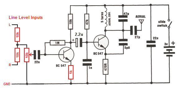

Hello, i've made this fm bug transmitter:
FMBUG
It works perfectly with the electret mic, (I use it to listen to the tv in the night), but i want to connect it to my laptop or any other audio source to make a tiny radio station to get fun (and to eliminate the annoying feedback sound), but i don't know how to attach it in the circuit. Can anyone help me with this?

Remove the electret microphone and 22k resistor. Connect the negative rail to the "ground" terminal of the "audio output" of the laptop and connect the 22n to the "audio out." Turn the volume down so the output is not overloaded.
Annoying feedback sound is caused when the microphone can hear the speaker and the sound goes around and around. Use headphones that completely cover your ears and are sealed then the microphone will not hear them.
You can add negative feedback to the audio transistor with an emitter resistor, add a volume control and add two resistors to mix the stereo channels together.
Doesn't the frequency drift when something moves toward the antenna or moves away?
Doesn't the frequency change as the battery voltage runs down?
Doesn't the the receiving FM radio sound muffled without high audio frequencies?
Will it transmit as far as across the street?
