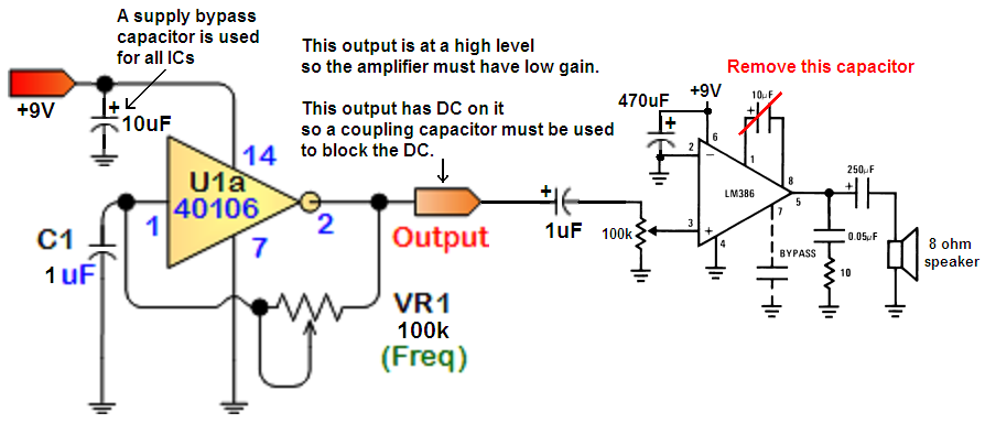

i was working on an lm386 audio amp for my tv, but it keeps buzzing. here is the schematic i used. **broken link removed** does anyone have a better one?

I am still having some trouble with pin, 3. I know it has been explained to me but i am clearly missing something here. I see a 10k resistor connected from ground to pin 3. but that is not correct and does not seem to work, Im very new at this and I realize it is a very basic thing, but again I can not seem to get it right. can someone please dumb this down for me, obviously i need it. If i connect a 10k audio taper pot to this it again does not seem to work? Audioguru you said it is a slider but i am not sure as to what you mean by this?
The resistor connected to Vin, pin 3 and ground is the volume control input. The resistor is a potentiometer (pot) with three (3) terminals. At Vin the signal is applied and developed across the resistor/pot from Vin to ground. The signal is tapped by the wiper of the pot and applied to pin 3. The pot acts as a voltage divider.
For the moment, consider the input impedance at pin 3 as infinite. If the pot were 10k and the wiper set at the midpoint of the resistance, there would be 5k on one side and 5k on the other. With a 2V signal at Vin, 1V would be developed across one half and 1V developed across the other, which would present a 1V signal at the amp's input. Adjusting the wiper toward ground would reduce the input to the amp, and with the wiper adjusted all the way to ground potential, zero input to the amp.

I am getting alot of feed back and distortion when I connect the Potentiometer to ground as well as connecting the 10k capacitor between pin 1 and pin 8. Is there any way to reduce the amount of feedback and distortion? This is happening before the oscillator is connected to the amplifier, just to clarify
Why are you connecting an oscillator to the input of the power amplifier?
Why are you connecting a capacitor from pin 1 to pin 8 which increses the gain 10 times?
Why do you connect the volume control wrong?

This is the schematic I am using, which is in the datasheet. According to this schematic a 10uf capacitor is to connect pins 1 and 8, secondly I asked how to connect the POT to pin 3 and was instructed on the previous page of this thread, that one terminal goes to ground one goes to Volts and the middle is connected to pin 3, this is how i preceived the instructions.
The potentiometer does not connect to "Volts." That is, it doesn't connect to the power supply. Vin is signal in, not volts in, "signal" being the square wave that you want to amplify.
Explanation: Vin means signal (input), while Vs or Vcc means power supply.
So one side terminal of the pot connects to ground, the other side terminal then becomes Vin and connects to your square wave generator (oscillator), and the center terminal connects to pin 3 of the LM386. Thus you turn the pot to vary the input to the LM386 from zero/ground to maximum.

As audioguru points out, the capacitor between pins 1 and 8 increases the gain of the LM386. No capacitor, the gain is 20. Capacitor added, the gain jumps to 200, which is a big jump. Too much gain could cause both distortion and feedback, so remove the capacitor (but first correct the Vin connection of the pot).

There's another issue with the now-infamous Vin connection. Specifically: how to connect the oscillator output to the LM381 amplifier input (Vin).
Bottom line: simply using a piece of wire might not be so hot. Use a capacitor, maybe a .1uF. One terminal (lead/wire) of the capacitor connects to one of the side terminals of the pot (Vin), the other terminal connects to the oscillator output.
The other side of the pot still connects to ground, the center terminal still connects to pin 3 of the LM381.

I wish you continued your thread about the oscillator.
The oscillator and the LM386 power amplifier were missing important supply bypass capacitors.
The oscillator had a very high output level and your LM386 power amplifier had a gain that was much too high.
The oscillator had DC on its outout that must be blocked with a coupling capacitor.
Make it like this:

We forgot to tell you that the ground of the oscillator circuit must connect to the ground of the amplifier. Usually the shielded audio cable between them connects the two grounds together.
A simple mixer can be made from two resistors feeding the volume control. One resistor from the oscillator and the other resistor from the other input. If you use 10k resistors and a 10k volume control then the resistors reduce the input signal to the amplifier a little.
